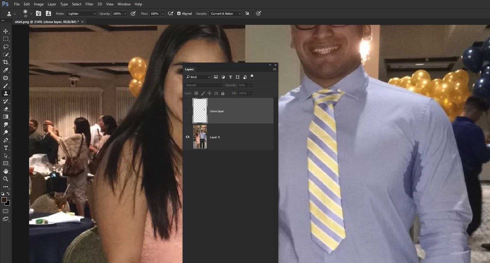

    Hi Eternal Warrior,
    not to worry , it's happened before and probably will again. As Dave says it's best not to do the work for an OP, but instead give a guide to how to do it.
    It's dead easy to do and took me 5 mins so I shouldn't be moaning
    1) Just create an empty layer to do some cloning onto
    2) Press 's' on the keyboard to select the clone stamp tool. Make sure the brush has a soft edge and set the brush mode to 'lighten'. Current and Below also needs to be selected.
    Then simply clone from a clean part of the shirt onto the under arm stain. The 'lighten' mode ensures that the clone is only applied to pixels that are darker in the underlying layer
    3) Finally give the top layer a few pixels of blur to make things blend in.
