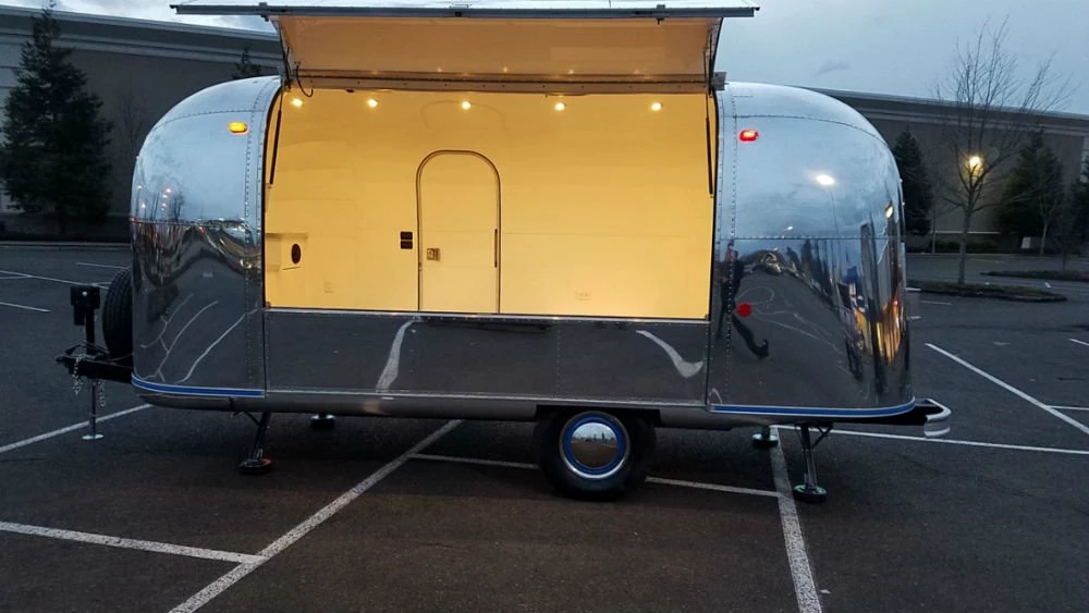

I want to take this picture of an Airstream (that was photographed in a parking lot) and place it in a forest.  So I have two (2) problems:
1.  How can I remove the original reflections and...
2.  How can I make realistic reflections of trees and other things that might be in the forest (trees, grass, streams, etc)
I have a lot of shiny objects that I'll be shooting (and CAN'T move), so this is a technique, or several techniques, that I need to learn.
Thanks for any help!

Although changing the camera elevation when you do the original photography may alter the amount of current reflection on the Arirstream, it is possible that the repacment reflection over the current one will make removing the current one unnecessary.  View the area several times throughout the day and determine which provides optimum time to do the photography.  (The tilted horizon line suggests this shot was handheld. I urge you to use a tripod.)
For this type of image, one thing you should learn is proficiency with the Pen tool. It will be needed in order to create a precise silhouette of the Airstream. (From its Path you will make a Selection and then a Mask.) Also, learn to use Curves, Levels or the Screen command to lighten a duplicate layer of the current image. It will make the silhouetting a bit easier to see. Once the Mask is made you can delete the lightened layer.
The reflection to appear on the side of the Airstream will be a vertically flipped version of a section of the forest image you choose. Consider a slight blur, as well. Google images with a similar effect as a guide. Do not Warp the reflection. It will make the side of the Airstream a tad dented.
In all, you will have at least three layers: the forest layer, the Airstream layer and the reflection layer.
Good luck.
Norman,
Your point in the first paragraph is one that I hadn't considered.  You are correct.  Might just might be that placing the new reflections will cover most of the reflections that are already there.  Then healing or cloning might be able to remove the remaining objects that I don't want.
Using 2 more curves layers, with clipping masks, for tinting and shading might also make the effect complete.
Thanks for the alternative perspective.
