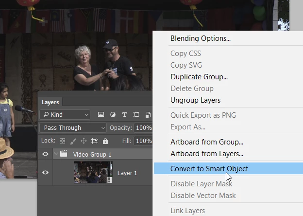

    Correct answer Trevor.Dennis
    Right click the Video Group in the layers panel, and convert to Smart Object.  Note that is the group and not the video layer

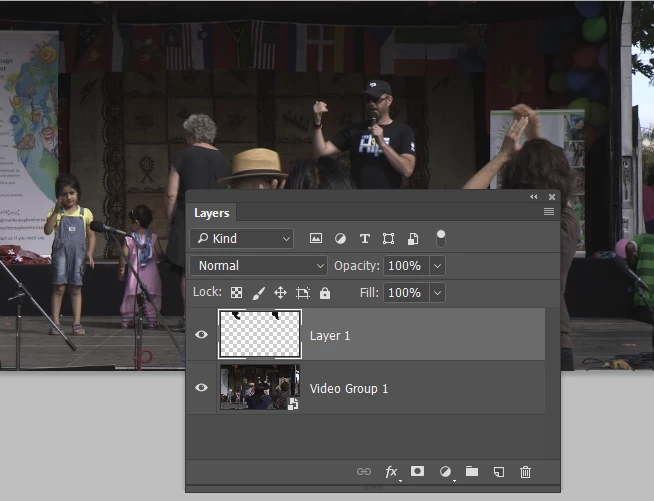

    Add a new layer, and with Sample all Layers checked, paint out the problem area with the healing brush.  Note that the tassels above the stage are no longer there.

    Trevor.Dennis
    June 25, 2017
    JJ, it is a wee bit ironic, but I don't think you can do this with Premiere Pro, but it works like a charm with Photoshop.  I guess Photoshop had the healing brush in the first place, and the way Photoshop handles video — the Smart Object approach — might have helped.  Like you say, it is only useful if the camera doesn't move.  Effects in PremPro and After Effects do track, but I wonder if that functionality is what makes it difficult to do a healing brush edit in those applications?

    Trevor.Dennis
    Trevor.DennisCommunity ExpertCorrect answer
    June 25, 2017
