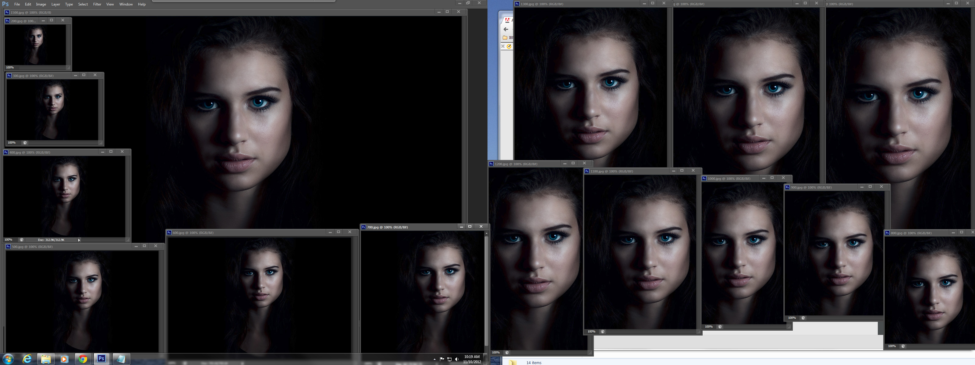

I'm on windows find the bicubicsharper does not work well it the image being resized has been highly sharpened all ready. Because of my Photoshop preferences I had to make minor modification to your script. I'm also a bit colorblind so i don't see many color issues so I include a screen capture if what windows does with your image and script.

You can open the screen capture in a new tab or window and zoom to see actual pixels I saw no problem either,
