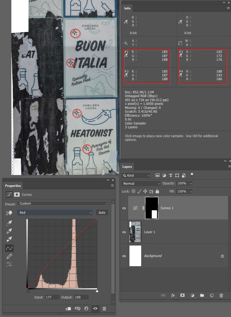

I like to use the numbers because it takes the guesswork out of it.
So I select the colour sampler tool, and add sample points in the required locations
Drag the Info  panel close so you can see what is going on.
Select one of the comic strip windows, and with that select active, add a Curves layer
You'll need to select the colour sampler tool again to be able to see the numbers in the Info panel.
In the curves properties, use the RGB drop down and chose the first channel.   In the screen shot below, I have the  reds  selected.  You can see a spike which represents the large area of the same tone, so add a point there.
Then adjust the Output value to match the other location.  So in my example, I matched the values for point #3 with point #1.
Repeat that for Green and blue.  I was easily able to get them identical, and the numbers don't lie.
Then do the other locations with a new curves layer, but remember to select the window  first so that the curve's mask restricts the adjustment to just that area.

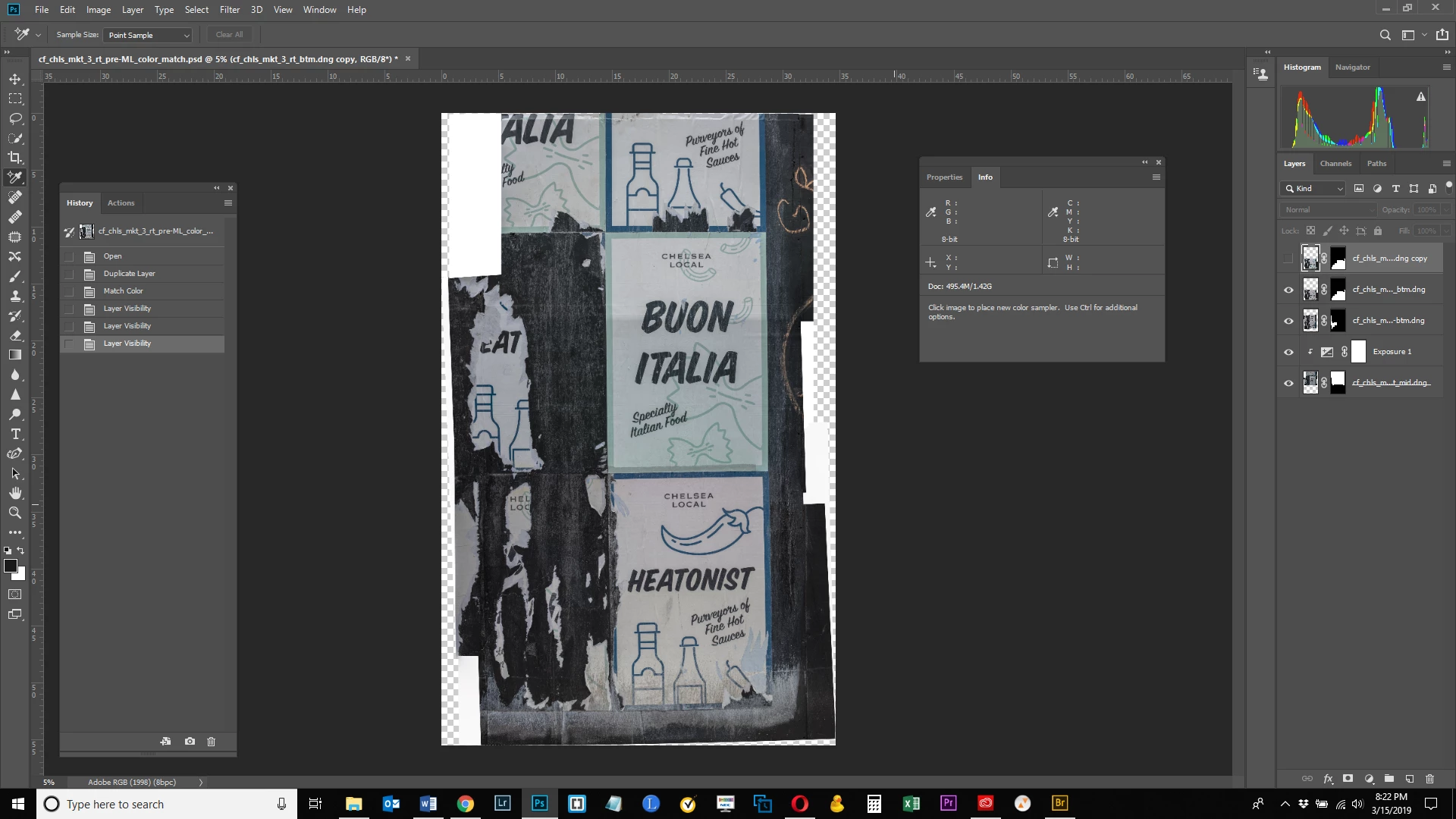

Hi Trevor this looks really cool and I started fiddling with it.  But I have a question:  it looks like you merged the 3 layers in my example into one layer (per the screen shot of your Layers panel).  Do I need to do that before proceeding?  In my screen shots below I am up to the step where I add the Curves Layer (screen shot #1) and then find a point which makes the color better (screen shot #2).  This was purely a guess by me moving the curve to where I thought it looked good.  Is this the idea?  I didn't really understand your criteria for selecting a point - perhaps because I don't understand the Curves graph and what it represents.  I probably need to find a tutorial or explanation of the graph so I can fully understand what I'm doing here.

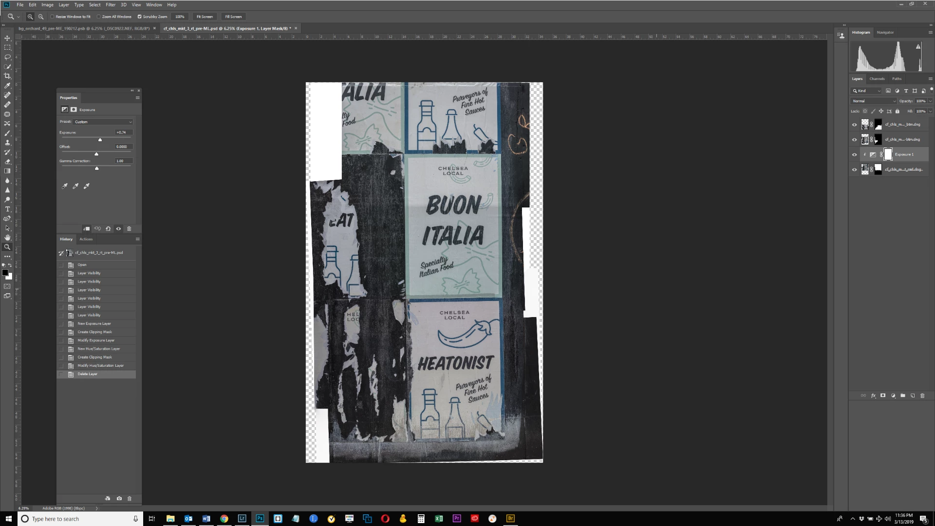

This worked fairly well, thank you.  Before and after shots below.  Instead of making the upper poster more like the bottom though, I did the reverse.

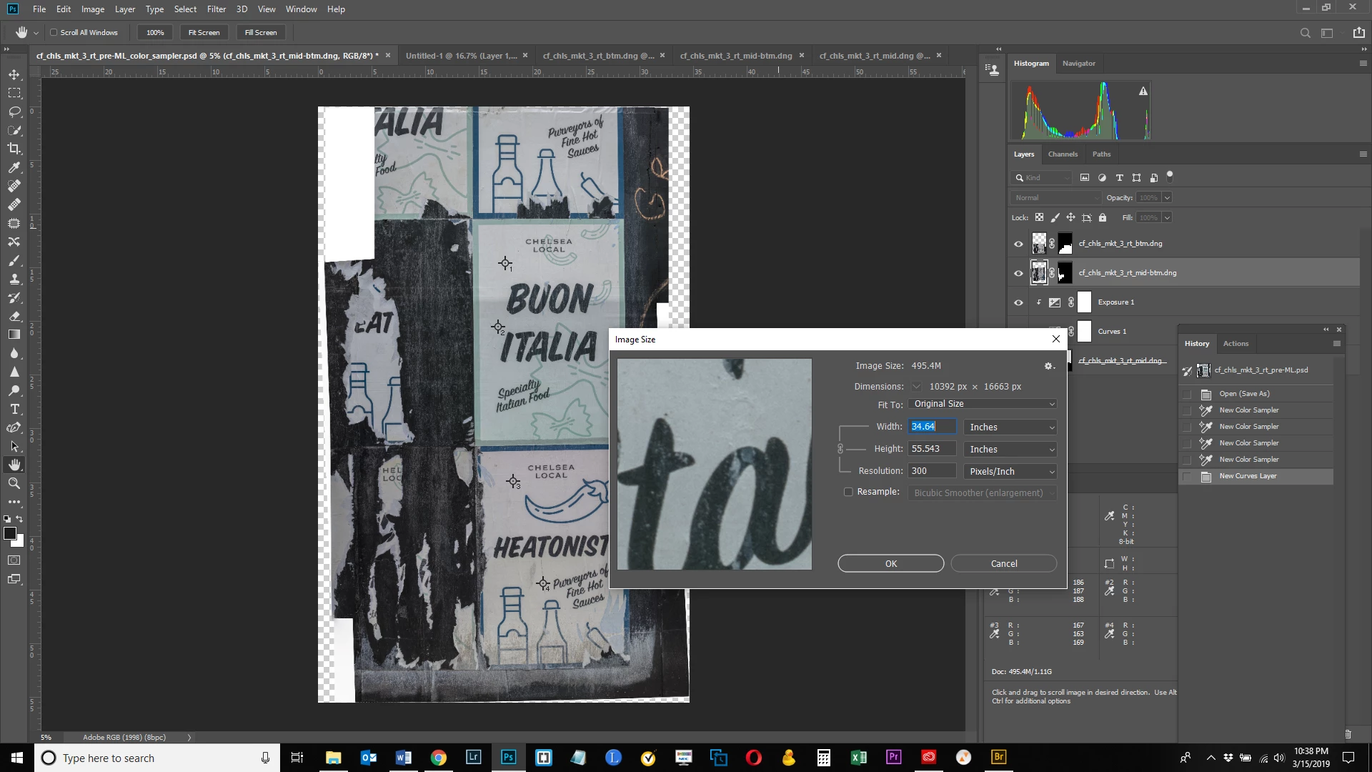

Thanks JJMack.  I found instructions on how to use Auto Blend.  It said first create a new document and then open all your layers, and bring them into the new document as separate layers.  For the blank document, I chose Custom and made the Image Size equivalent to one of the 3 layers (30" x 50").  When I brought the layer into the new document, it appears very large.  See screen shots.  Why is this?  Thanks.
My original document before creating new one for auto blend.  Dimensions is 35" x 55".
New document for auto blend with 1 of the 3 layers brought into it.  The new document also has dimensions of 35 x 55.  Why does the layer appear so big in the new document?
