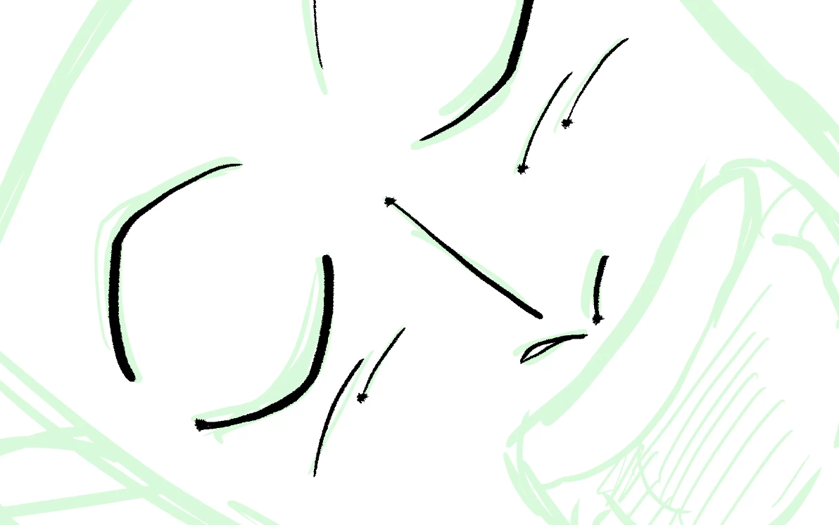

I get these random spots whenever i use my brush on Photoshop 2020. It never happened before in the older version. I use a Cintiq Pro 13. This is frustrating ...  My driver is updated,  these spots are driving me crazy XD
example :
{Thread title edited by moderator}

On a Windows system, I had to reduce the Wacom Tip Feel to Soft, or near Soft.
  Now no more blotches

Hi - My Wacom Pen has been leaving splodges at the end of lines for months and it's been driving me crazy too.
I think I've found the solution just now - Wacom have added a feature called 'tip up assist', which is to 'help accurately place control points on your screen' (more info here: https://www.wacom.com/en-th/support?gu=&guideTitle=What-is-Tip-Up-Assist-and-what-does-it-do%3F&guideId=151-181) I switched off tip-up assist, and the splodges are gone. Hope it works for you too.
• Go into your Wacom pen settings.
• Click Options at the bottom of the panel.
• A third of the way down you'll see Tip-Up Assist - uncheck the box and hopefully say goodbye to splodges.
Cheers
A

I have the latest version of photoshop. My iMac is Catalina version 10.15.7 which I believe is the latest. my Wacom driver is up to date. I have done everything possible to fix this issue and yet nothing seems to be working. did a photoshop reset and that didn't work, installed an older version of photoshop and the same issues were still present. did a photoshop preference reset and nothing happened. checked my brushes and followed instructions on how to change brush settings and nothing worked, even contacted Wacom and they sent a replacement pen because we thought it was the pen but nothing changed. I decided to use a different art program "clip Studio", and realized that it DIDN'T happen with clip studio so the issue is from Adobe. what are you guys doing to resolve this??

Maybe a long shot here, but have either of you got the Airbrush option turned on in the Options Bar (see screenshot below)? Probably not the cause as you have to hold your pen to the canvas stationary for a few seconds to start seeing the "blob" effect, but I thought I'd mention it just in case.
What happens if you do the same thing with your mouse or trackpad? Do you still see blobs? Also, you might want to check and see if your pressure sensitivity settings for the pen has changed. If it's set to very light and you press a bit harder initially then it might leave a wider spread initially. It does look like a pressure issue to be honest.
I'm still thinking on this one and if I can come up with anything more I'll drop back, but have a look at those things first and see if they make any sense to you. Incidentally, FWIW (not much) I have the Cintiq Pro 24 and am not seeing that. I'm wondering if it uses the same driver set that the 13 uses (very possibly), in which case it's probably not a driver issue.
EDIT - I actually have the 13 as well so I'll check it out this morning and see if I get the same thing. It'll take me a couple of hours or so, but I'll report back either way.
May 19, 2020
Ok, so I just tried it on my own Cintiq 13 and could not reproduce the problem. I have the same version of PS and am using Catalina as well so the setup is pretty close to the same (except I'm running on a MacBook Air 2). Can you let me know the following: 1. What brush(es) are you using (i.e. is there one brush that's doing this, or any of the brushes)? What are the brush settings? Do you have Pressure Sensitivity turned on? Is the Airbrush option engaged? Are you using the Pro Pen 2 (the "2" is important)? Any chance you're using the Artist Pen that Wacom had for the Intuos a while back?
Since I'm not finding the same issue it's unlikely to be the driver. It kind of sounds like a setting somewhere. Maybe with the above info, we can nail this down.
May 20, 2020
Thank you Glenn for your quick reply.
I tried a few brushes and the default brushes seemed to work well. I looked through my main brushes disabling different brush settings in turn. Disabling Build-up fixed the problem. I can understand why. The part that confuses me is why this wasn't a problem before.
Thank you for putting me on the right track. Thankfully it was just one setting in the brush. nab2000, I hope this helps you too.
Kind Regards,
Zak

Thank you nab2000 for posting about this. I have the same problem. A lot of my pen strokes begin with a blotch and I have to keep undoing the strokes.
I have just clean installed my OS with new drivers from Wacom, but it didn't fix the problem. I have the following:
MacBook Pro (Retina, 15-inch, Mid 2015)
macOS Catalina
Photoshop 2020 (21.1.2 release)
Wacom Cintiq 13HD DTK-1301
Looking forward to hearing back soon.
