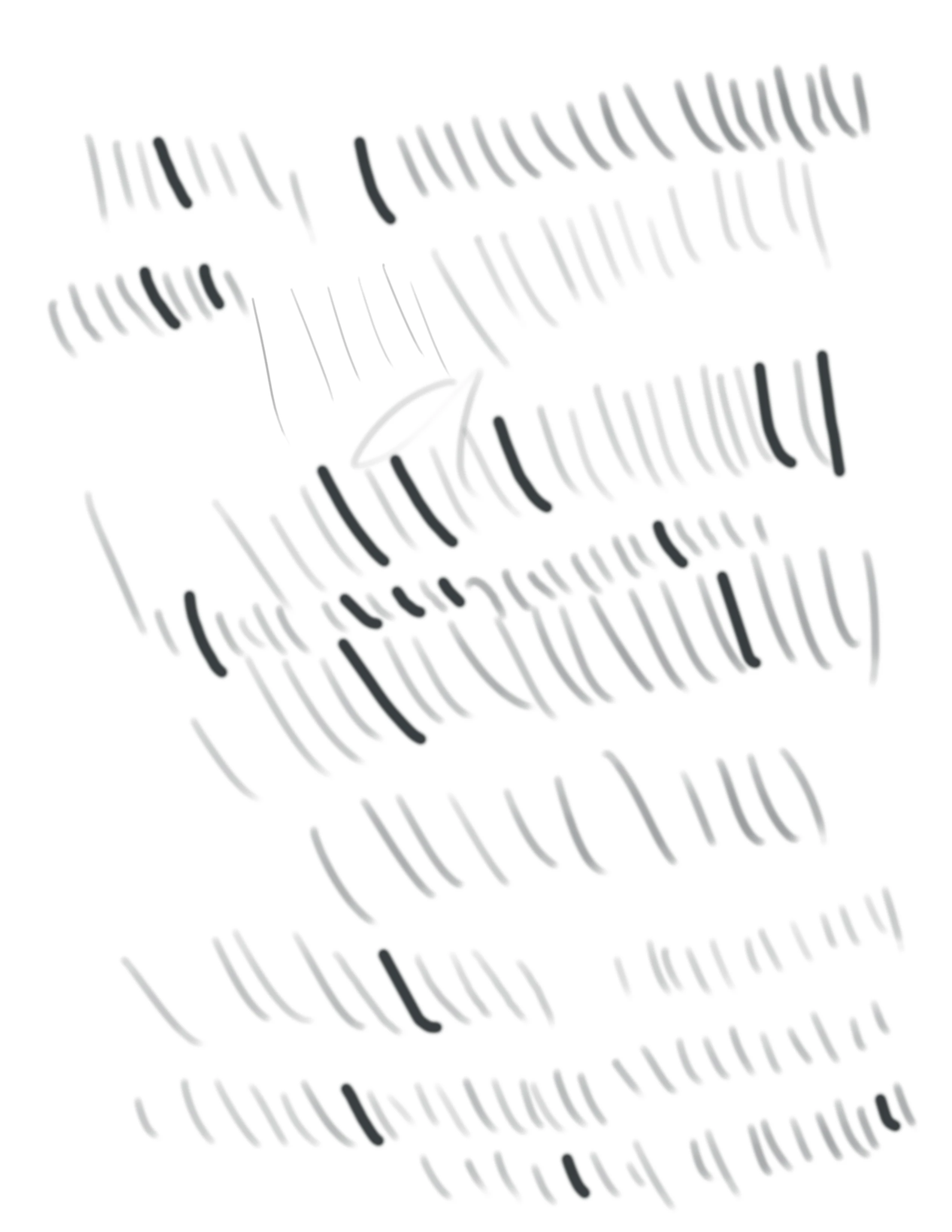

Hi, I could really use some help! I just got a brand new Intuos Pro M and am using Photoshop CS6 on Windows 10. It seemed fine at first, and then I started to have random strokes that don't have any pen pressure like this. I've tried uninstalling/reinstalling current drivers. I've turned 'tip double click distance' off and disabled the double click on the pen button. I have windows ink turned off. The only thing I found that helps temporarily is putting the cable in a different usb slot. But it has come back again after that, so not a solution. Help! I might switch back to my Intuos 3 if this keeps happening

April 30, 2019
Every so often now the brush will just make straight lines like this when I try to create a brush stroke. If I switch around to another file, or wait a while it goes away, but comes back and now it's happening more frequently.

April 30, 2019
Hi Anna,
That does not sound right, as the pen is drawing random strokes due to less pressure sensitivity, could you please try the steps mentioned here and let us know if it helps?
Tablet support for Photoshop on Windows 8
Sahil
April 30, 2019
I have tried clicking the Windows Ink both on and off here without any difference.
