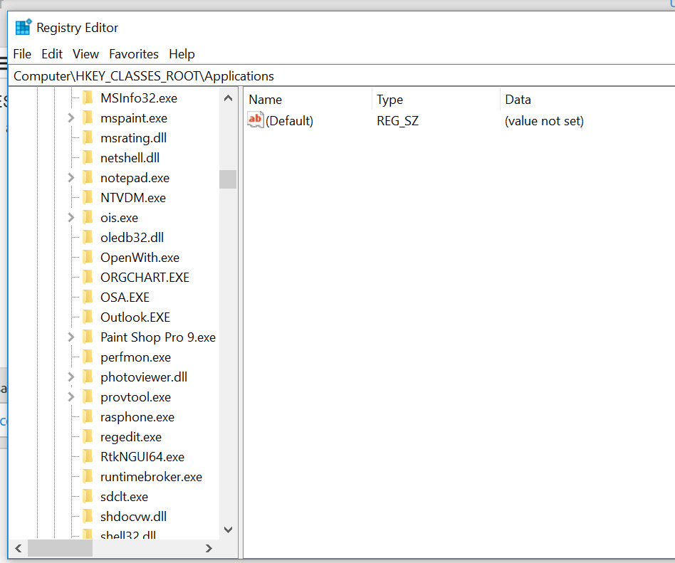

I cannot open an image directly into photoshop CC 2018 by right clicking. PS CC 2018 does not show as a default program in the list. I've gone into browse and tried to add it by going to Adobe, Adobe photoshop 2018, choosing the program file, but nothing.
    Correct answer
    If you're on Windows have a look in the registry in this location and see if the Photoshop.exe key is set
    HKEY_CLASSES_ROOT\Applications\Photoshop.exe\shell\open\command
    You should see the below
    To open the registry just type regedit in the run command

    If you are unsure about editing the Windows Registry, there is a way using the [Open with] menus to add Photoshop as a default:
    1) Select a file and choose [Open with]
    2) [Choose another App]
    3) Scroll down and [Choose another app on your pc]
    4) In the Explorer window navigate to {C:\Program Files\Adobe\Adobe Photoshop 2023}
    5) Select {Photoshop.exe}

    Here's what worked for me to force Windows 10 to display Photoshop CC23 as an app for opening JPGs, PNGs, and even PSDs.  In the registry, navigate to HKEY_CLASSES_ROOT\*.xxx (xxx being the extension/file type you wish to associate with Photoshop)  Open the folder of that extension.  If you do not see a KEY that reads OpenWithProgIds, you'll need to create one.   First, make a NEW KEY.  Name that new key OpenWithProgIds. Then, make a NEW STRING VALUE.  In the value name box, type Photoshop.Image.xx (xx being the version number of the current installed version of Photoshop)  In this case, I'm on version 24.0.1.    You may need to search the registry for a String Value that includes Photoshop.Image.    Once you've finished making this new key, save the registry.   Then, find a file with the file format/type you wish to associate with Photoshop.  When you right-click on the file, and then "Open With" - the latest version of Photoshop should be in that branched right-click sub-menu.  From there, scroll to Choose another app.  Another dialog box should open.  At the top of that new list should be the latest version of Photoshop.   Select it.  Then check the box that reads "always use this app to open xxx files".  That should fix the problem.

    I have "C:\Program Files\Adobe\Adobe Photoshop CC 2018\Photoshop.exe" "%1" in
    both HKEY_CLASSES_ROOT\Applications\Photoshop.exe\shell\edit\command and HKEY_CLASSES_ROOT\SystemFileAssociations\image\shell\edit\command.
    When i right click and click Edit, photoshop is opened but image isn't!
    June 8, 2021
    Edit: right-click and click on "edit" a psd or another photoshop file, photoshop opens that file. But if i click on "edit" an image in jpg, bmp, gif, png etc. file types, photoshop doesn't open such images. Opening such files works with right-click and click on "open with".

    Correct answer
    March 24, 2018
