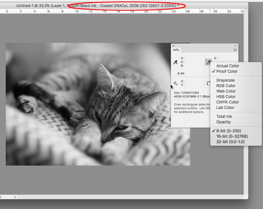

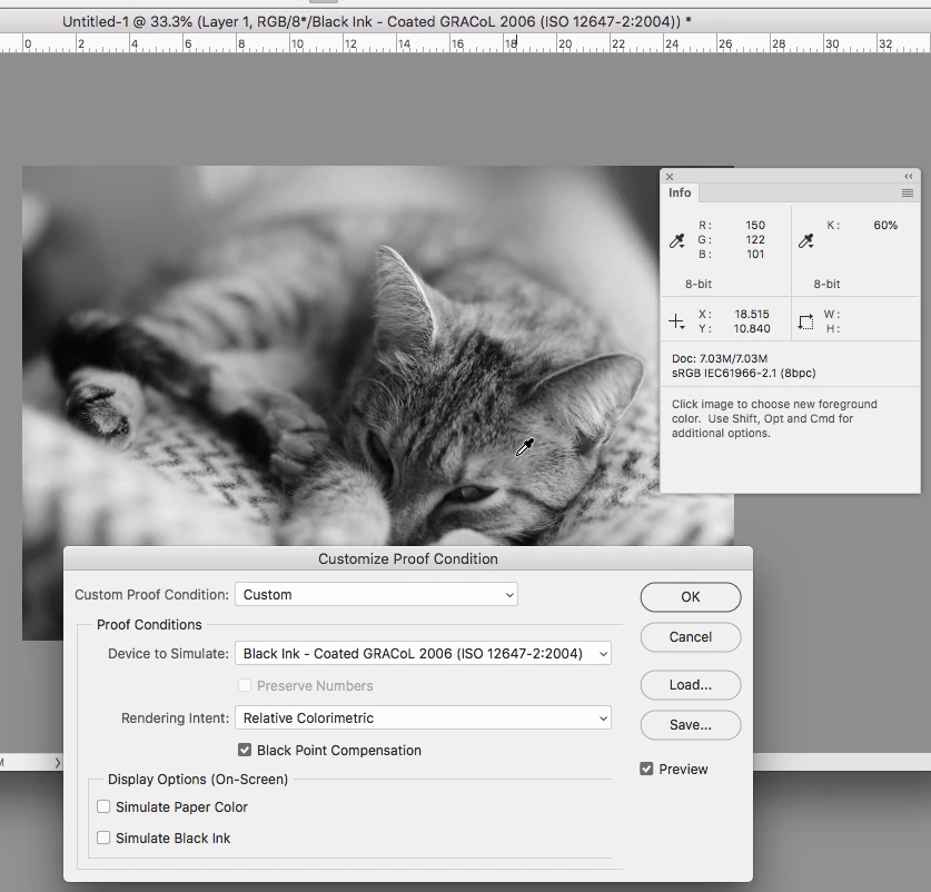

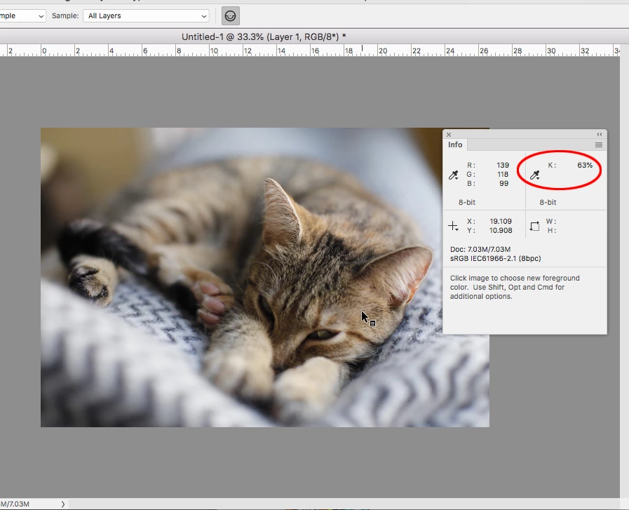

To illustrate Chuck’s answer, here I’ve set the 2nd Info sampler to Proof Color, and have set the Proof Setup’s Device to Simulate to a Gray profile. Toggling Proof Colors on and off changes the preview between the Actual Color (RGB) and a Grayscale simulation:

From his comments, it's a proof set up in grayscale:
"Hey TAG, it is pressing ctrl Y . It is the shortcut for View - Proof Setup. To change it to greyscale you have to go there and change the proof setup to custom - Greyscale. Sorry that it is kinda confusing. Hope it helps :)"
