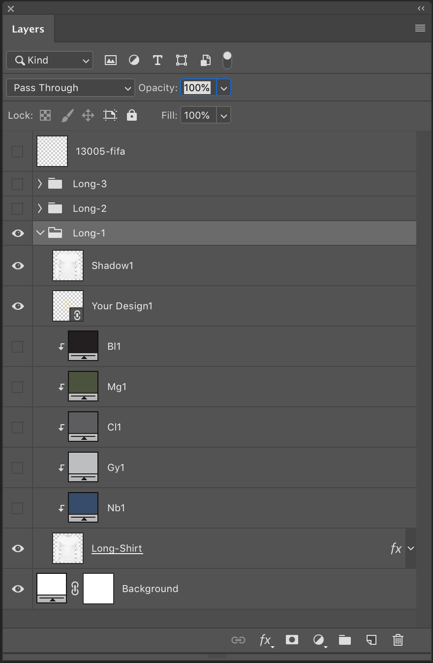

I have a T-Shirt mockup file with 3 or 4 different templates (Style) in 1 PSD file.
I load my design to templates and after resize it (depend on template) and move them to right position, then using Actions for make JPG files for my web-store.
I have 3-4 templates and each template have 6 colors.
At the moment, I made 4 folders (like 3L-1, 3L-2, 3L-3 ,...).

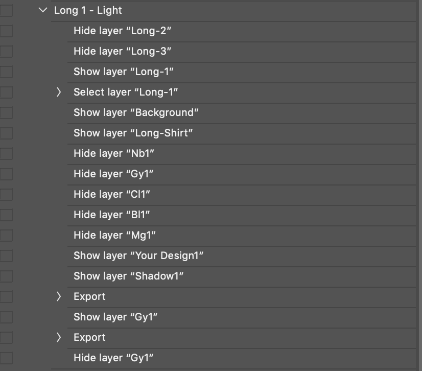

By Using Actions, in each folder, save files by these name "3Wh_.jpg", "3Gr_.jpg", "3Bl_.jpg", "3Mg_.jpg", "3Nb_.jpg" and "3Cl_.jpg" through Save for Web (Legacy). (the alphabets indicate colors like Wh=White)

my question is:
I heard that can do these steps easier in PhotoShop by using script but don't know too much about Java Scripts.
I add a blank layer as top layer and write "Design code" as the layer's name.
I want to use this layer's name in filename when making JPG files by Save for web. (the filename template will be like this  3Wh_LayerName-1.jpg, 3Wh_LayerName-2.jpg , ..., 3Bl_LayerName-4.jpg & .... )
Can anybody help and guide me to do this ?
Thanks
P.S: I'm using PhotoShop CC 20 on Mac system.

now if I can find a way (write the script) that my current Action using "saveFile" & "docpath" instead of fixed filename (that I entered when recorded the Action), I guess everything will be done.
here is the script that I got by script listener when run my current Action.
var idPly = charIDToTypeID( "Ply " );
    var desc116 = new ActionDescriptor();
    var idnull = charIDToTypeID( "null" );
        var ref54 = new ActionReference();
        var idActn = charIDToTypeID( "Actn" );
        ref54.putName( idActn, "Long 1 - Light" );
        var idASet = charIDToTypeID( "ASet" );
        ref54.putName( idASet, "DC Preview" );
    desc116.putReference( idnull, ref54 );
executeAction( idPly, desc116, DialogModes.NO );

The script action you recorded can be used for any action. Put it in a function to just replace the name of the action:
runAction(actionName){
//action manage code here
//replace the action name in line 7 with actionName}
Run the function like this:
runAction('My Action Name')
It's actually a good idea to use scriptListener to record you actions, so they are all in your script, and don't have to actually maintain the link to where your actions are stored. Makes it easier when switching computers.

let me explain a bit more about what I want to do.
here is my layers
and here is the Action that I made for that
it worked fine and just I needed to use Top layer's name in FileName that exports.
therefore every time that I change the design and Top layer's name, it can make new filename(s) by running the Action.
I couldn't find a way in Photoshop to do it and therefore decide to use Scripts.
