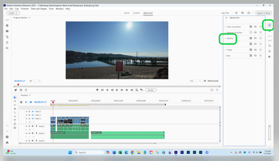

Apr 07, 2025 Apr 07, 2025
Does this help?  The three bars on the left edge open up the menu with "Volume" on it.

Chris,
I made a mistake.  I meant to post a screen shot of where the volume tool is in the Quick view.  It works the same in both Quick and Advanced.   I was trying to not force you to use the Advanced mode.

Apr 09, 2025 Apr 09, 2025
I made another mistake Chris.  I put up a screenshot from the 2025 version.  The 2024 version has the Quick mode volume control in a different spot.   This is from 2024.
