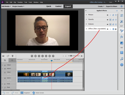

Premiere Elements 2021 version 19.0 running on Windows 10, running in Expert mode.
  • Beginning a new project, I applied an audio effect (a compressor) to a 30 minute clip, then began editing the clip to remove pauses, 'uhs', etc.
    • I disconnected my network connection because I was having a problem with playback stopping by itself frequently enough to be irritating. A forum post suggested trying that. It seemed to help, at least after a few minutes.
  • I closed the project to take a break.
  • When I reopened the project (internet still disconnected), the audio sounded low. I checked for the compressor, and under 'Applied Effects', the box where the compressor effect should be read Offline (filter unavailable)
  • Hmmm, OK the internet was disconnected. Was this effect looking for a network connection for some reason?
  • I reconnected the network cable, half expecting the effect to magically reappear.
    • It didn't.
  • I closed the project, reopened it... still Offline (effect unavailable)
    • I rebooted the PC. No help.
  • I searched the forum for the keywords "Applied Effects" "Offline (filter unavailable)".
    • I didn't find anything specifically germane, but one post mentioned something about that issue, and noted that the user reapplied an effect, but when they closed the project and reopened it, the effect was Offline again.
  • I deleted that 'effect' with the trash icon, and reapplied the effect.
  • I closed the project, and reopened it.
  • The effect was Offline again for me, too.
  • I opened an early version of the project from the Auto-Save folder.
    • This version was very early, after I had applied the compressor effect to the long clip, and before I began editing it.
  • The effect was Offline here, too.
  • Next, I created a completely new project.
    • I applied my compressor effect
    • The effect was Offline!!
    • I applied a video effect (a blur)
      • Close, reopen..
      • the blur is still there
  • It occured to me that I was using a 'My Presets' saved effect.
    • So I deleted the 'offline' effect (I'm still in the 'new' project)
    • and applied the 'original' version of the effect from the FX panel
  • Close, reopen the project (close Premiere Elements completely, not just reselecting a project)
  • The 'new' effect was Offline!! (OK, that surprised me)
  • I deleted the Offline compressor, and applied a lowpass filter, just to try a different effect.
    • confidence level: low
    • Offline!! (low confidence justified)
  • Opened an 'old' project (from a week ago) that used the same compressor effect (ALL my projects use that compressor effect, if they have any audio in them)
    • You're guessing 'Offline', but nope, the compressor was there!

Workaround Solution:
  • I added a video clip from another project (a 1080p camera video clip) to the Project Assets of my test and original project. After Saving, Closing and Opening the project, the 'offline' audio effects all became 'online' again.
Read below for a play-by-play of my troubleshooting steps:
The next morning (and we're now in Play by Play Troubleshooting mode)
  • The source video I've been using came from a Zoom cloud recording. It's a 720p .mp4 file.
    • A test I did a few minutes before starting today's log indicates that may be key, but I don't see why (yet?).
    • I started another new project (Offline Effect Test 2), but this time with different footage from a video camera, 1080p.
      • I added the audio effect, closed and re-opened Elements.
      • The effect was still present in the timeline. It had not 'gone offline'.
      • I added the video from my Zoom meeting to that new project, and tagged it to the end of the timeline. Then I added the audio effect to that clip.
      • Close, re-open... the effect is still there! On the 'bad' video clip.
        • Now we're getting into 'workaround' territory, at least.
    • I start a third new project (Offline Effect Test 3).
      • First, I just bring in my Zoom meeting footage, and apply the audio effect.
      • Close (Save), Open, Effect Offline.
      • I bring that 1080p camera footage into this project..
        • add it to the end of the timeline
        • add the audio effect
          • so far, the audio effect on the Zoom clip is still offline
      • Close (Save), Open.... drumroll.... The effect is still there on both clips!
        • definately in workaround territory.
    • I re-run this test as Offline Effect Test 4. Same result - the effect has not gone offline.
    • Curious, I delete the 1080 footage from the timeline and the Project Assets.
      • Close (Save), Open, and the effect is still there.
      • Risking all, I make a few edits, just to manipulate the timeline some.
        • Close, Open, Weirdness:
          • I edited the footage into three clips.
          • The effect is offline on two of the clips
          • and online (present) on the third clip.
      • I add back a 1080 clip. I do not add an audio effect to that clip
        • Close, Open, and the effect is present on all three Zoom clips.
      • I delete the 1080 clip from the timeline and Project Assets box again.
        • Close, Open, still there in the Zoom media, all three edits.
        • Add another edit (1080 media still out of the project).
        • Close, Open, effect is present in clips 1, 2 and 4, but missing from 3.
  • Next, added a 1080 clip to the Project Assets, but not the timeline.
    • Close, Open... effect is present in all edited clips!!!
    • I think we have a workaround.
  • Holding breath, opening original project...
    • I had made a few dozen edits to the original, single Zoom 720 media file.
    • Some still had offline effects, and some still had online effects. Most had no effect, but I don't really remember the quick screwing around that I had done while still in WTF mode.
    • So I deleted the offline and online effects in all but the first few edits (tediously, clip by clip). I left the (offline) effects in the first few clips to see what happened when I added a 1080p clip to the project.
    • Close, Open, and all the offline effects I had left in the first few edits came back to life.
To review:
  • Audio effects clips went 'offline' when I closed and re-opened a project with footage saved and downloaded from the Zoom cloud.
  • Other Elements projects, including one with a different Zoom cloud video clip, continue to work properly.
  • Adding a 'good' clip to the project (a 1080p clip from a video camera) fixed whatever was glitching in the program.
    • After adding that 1080 clip to the Project Assets - and not necessarily to the timeline...
    • ... then closing and re-opening the project...
    • ... restored all the 'offline' audio effects.

Between your two posts I tried to find an answer on my machine.  I think it is clear that you don't need my help.
I did learn something interesting, at least to me.  I first opened the 2022 version and couldn't find the Dynamics effect at all.  I still have the 2021 version so looked there and it is present.   And, it worked normally for me on a camera produced clip.
Apparently the effect has be removed for 2022.  A few other audio effects were missing too.  I don't have a guess as to why.  Nor will I miss them because I've not used them.

First... my workaround failed. All the edits seemed to have the effect applied, but when I rendered it out and played the rendered file in VLC, the compression was missing from maybe half of the edited clips. And when I looked at them back in Elements, sure enough they were offline. And this was with my magic 1080 clip in both the Project Assets and in the timeline. So back to square one on that.
I have been around the block enough times to know that it's impossible to make bug-free software (at least complex software), and the wide variety of configurations of Windows machines means some incompatabilites are inevitable and can't be fixed because no company can afford to investigate and solve problems at that individual machine level. And I get that a problem forum will collect dozens to hundreds of users with what is apparently the same problem, but that is still a tiny percentage of users.
That is cold comfort when you as an individual user are experiencing 100% of a problem that is a game-stopper on a project with a deadline. The project I'm working on is a freebie that I can just give up on, but across my career I've pulled many all-nighters finding solutions and then redoing hours of work once I did, for clients who were paying big bucks with tight deadlines. The memories remain bitter. And I'm left with the notion that I'm runing the same hardware that ran Pro pretty darn well, but Elements has thrown me curve after curve, either with glitches or limited design.
