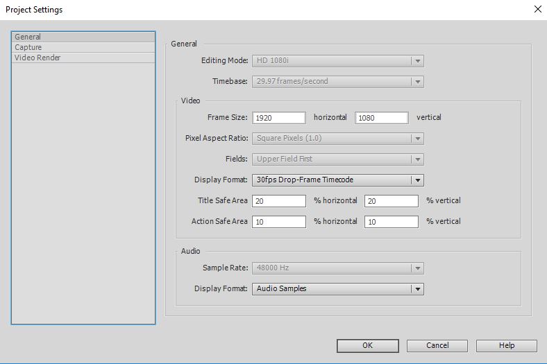

What are the project settings and how were they set?

I'm confused about the source footage, how you arrived at the project settings and why the 1280 x 720 MPEG output won't work.
Regarding "upscaling", the normal expectation, for best quality, is to have the source files, project settings and output settings all be the same.

I wouldn't say I arrived at the project settings. This is my first time using Premiere Elements 2018 so I'm learning. I've been using Photoshop Elements and Lightroom for a few years, but I am new to Premiere Elements. When I began a new project I just used the default settings; I didn't really think to look at them.
Why the 1280 x 720 MPEG output won't work.
It does work. The video downloaded just fine in MPEG. However, I can't play it with Windows Media Player. Also, the display TV plays MOV or MP4.
If I changed the project settings to match the source files do you think that would make a difference? I can't seem to change any of the project settings now; would I have to create a project and start all over again?
