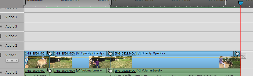

    When you add a clip from your phone to your timeline, is there a yellow orange "render" line above the clip? Ideally you should NOT see this render line because it indicates a mismatch of project settings and video specs.
    Cindyg22Author
    April 18, 2017
    No yellow line.  Here's a picture.  Does the gray area before the green line mean anything?
