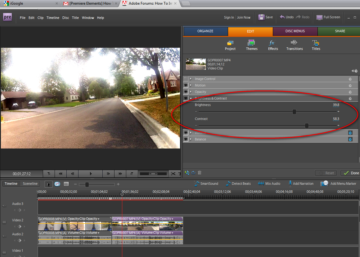

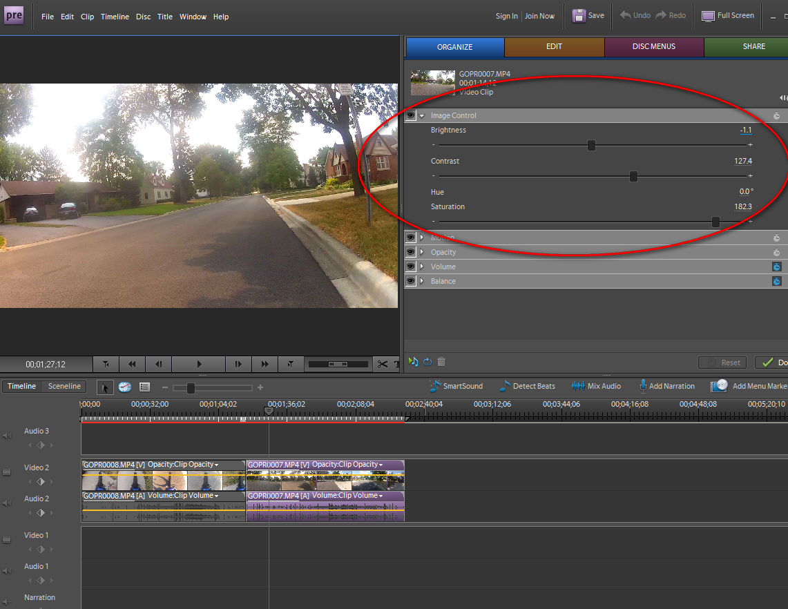

So, first of all, some screen shots.
Here's the controls I was playing with (this is PRE version 7, if it matters). I'd right click on a clip and select Properties. One of the edits that always shows up is the "Image Control". As you can see, it has Brightness, Contrast, and Saturation.
Then, Bill, I followed your instructions and instead of the standard "Image Control", I tried using the "Brightness and Contrast" Edit Effect (I turned the Image Control off via the eyeball). Not sure why, but the Edit Effect "Brightness and Contrast" seems to work differently - and much better - than the Image Control Brightness and Contrast sliders. Using the Edit Effect, I was able to get the video looking MUCH more like I was looking for, as you can see here.

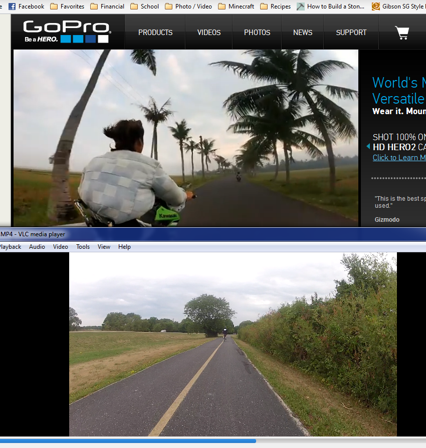

Secondly, I went to the GoPro site to look for examples where their stuff was really eye-popping and mine was bland, and wouldn't you know it: almost every video that looked fantastic was during the "golden hours" surrounding sunrise/sunset.
When I found a video on their site that kind of matched my lighting conditions, it was actually pretty similar. Here's a shot of video clip from their site superimposed overlayed with video I shot... as you can see, it's fairly close (of course, theirs has palm trees and mine has bushes )
So I think I have some workable solutions: use the Edit Effects instead of the "built-in" effects (i.e. "Image Control"), and shoot on clear, bright days an hour before sunset!
