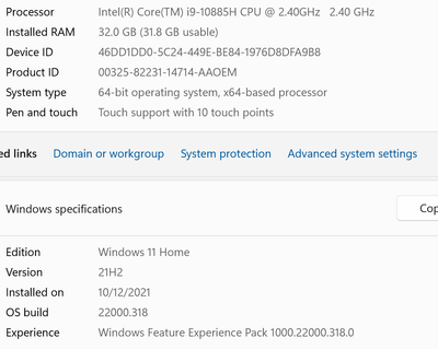

Well, with a more than capable laptop (see below specs) and after a few minutes of adding a clip or trying to, you know, edit and build a project it simply freezes.  It doesn't appear to be stressing the laptop (see below screen shot from the task manager) and it won't even close down unless I use the task manager.  It simply gives the hour glass.

 From my screen shots above it doesn't seem to be a hardware issue as 1) My laptop should certainly be able to handle what I am doing and 2) Adobe is only using ~17% of the CPU.
