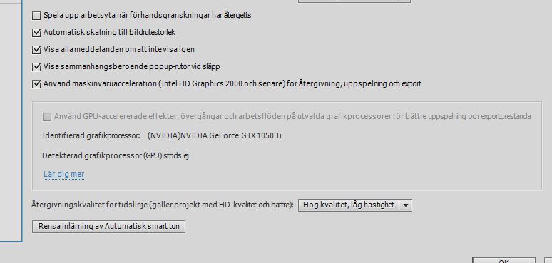

I managed to get another 20Gb free, and then both rendering and export seemed to work...BUT I am still not able to check for the choice of using my GeForce graphics card, which seems to be the right one? sorry it is in swedish, but I am sure you can figure it out? The box is not able to tickSkärmklipp.JPG

Thamks for you answer erlier. Now i have made my C drive to one Tb and updated my graphicscard...so all problems seem to be solved..
Thanks again, will be back if furhter new problems!

I'm not sure this will do anything but it might.  Try turning off hardware acceleration and the GPU support.  It won't make much difference on a short video.

Hi, thanks for answering. This did not help, though. Som more space on C drive did...will be back if more problems
