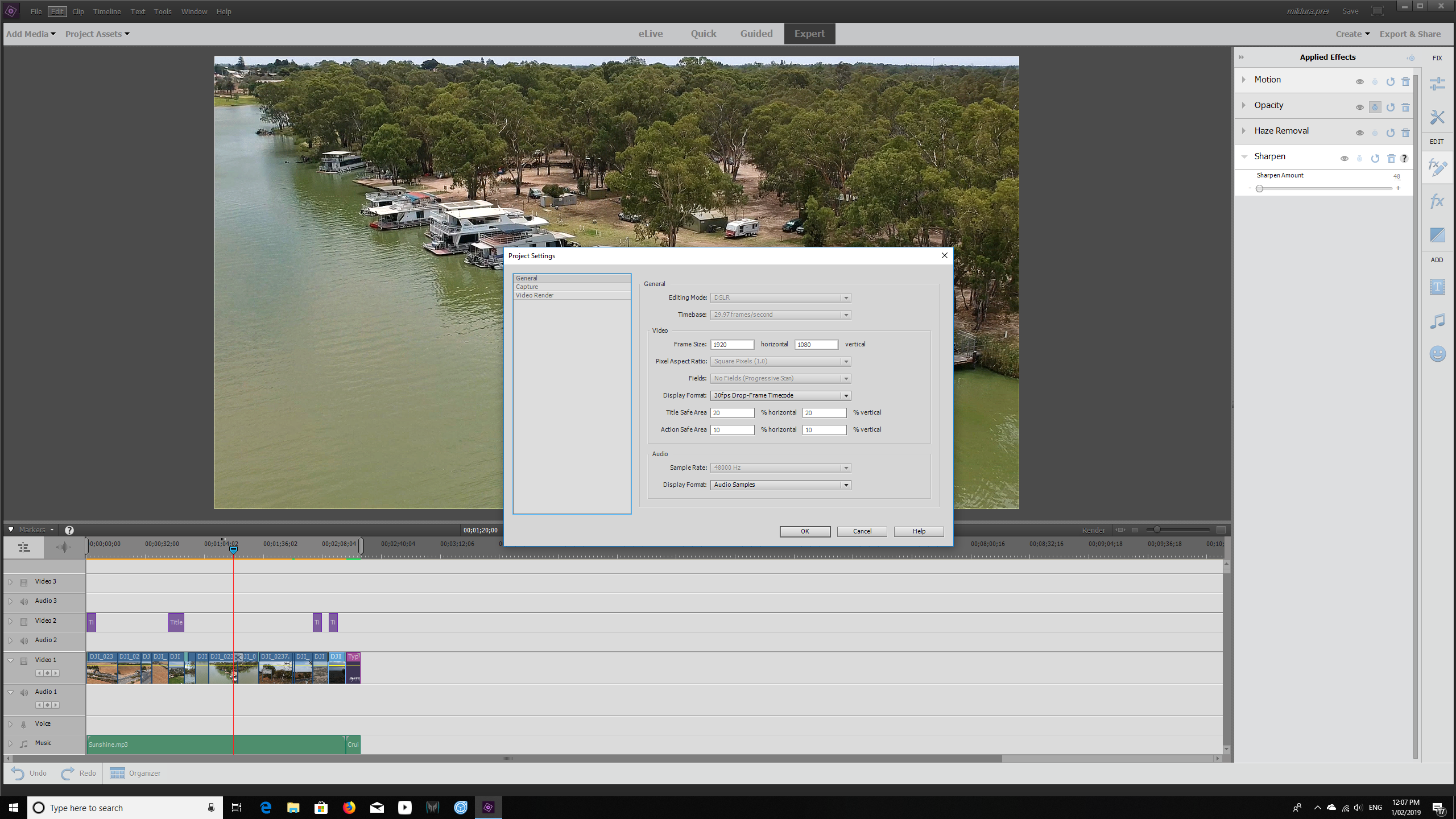

merg pic.pngThe image on the right is the project image and left is the rendered image. There is a quality loss if you notice the small jetty and overall pic quality and coulor
Community Beginner ,
Jan 31, 2019 Jan 31, 2019
render settings.PNGAs I stated previously, the line at the top only changes colour after I start adding effects. The naked file before effects has a green line all the way across. Cheers
