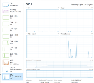

I can add that when I scrub to a new frame, that frame does come up and there is a quick spike in the GPU>Video Decode. Often though there would be a flash of the wrong frame first before showing the correct frame (perhaps showing the I frame first?)
