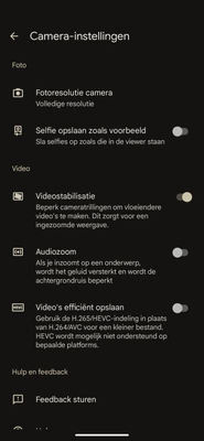

I checked my settings and it appears that I am shooting in H264.
