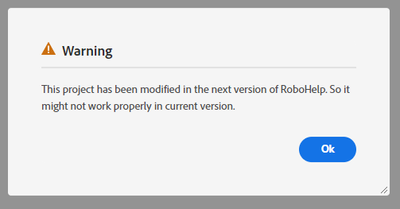

Explorer ,
Sep 08, 2023 Sep 08, 2023
and I get this error when I open my project, which is weird because it is the same version
There's a new patch out (#3) maybe you need to update to it?
