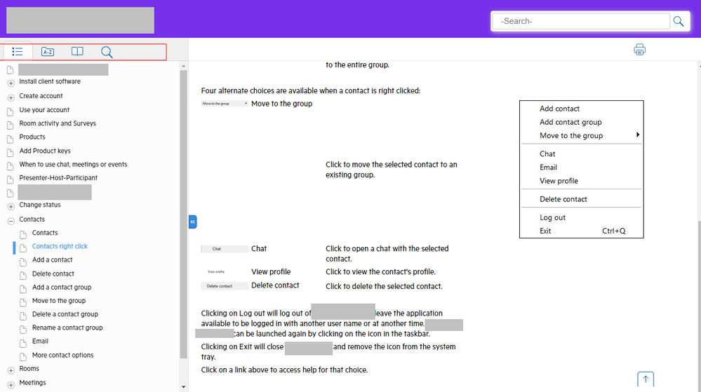

Oct 13, 2020 Oct 13, 2020
Yes, the screen layout completely changes as the window is resized. In the first picture attached, if I pull the window wide enough or go full screen, a second interior scrollbar appears and that one works.
However, as in the second picture, if I make the screen smaller so the TOC collapses and the tabs shift to the left instead of on top, the inside scrollbar disappears and the outer one is non-functional.
Then if I expand the window again and the TOC expands with tabs back up above, the inside scrollbar does not reappear, I have to go to the next page that is longer than the window for it to reappear. Hence, as far as I'm seeing it, the responsive nature as you explain above is not functioning properly.

I have edited your post to put the description of what happens in each screenshot immediately above it. Please use the Blue button on the web as for some reason the forum made it difficult to separate those images. I have also just found that if you now resize the forum window it is still messing up so I will try to fix that next.
Please go to https://www.grainge.org/pages/authoring/rh_tour/introduction/introduction.htm and try the same exercise. For me that is working and the scroll bars remain visible on a Windows PC using Edge.
If you find the same then it pretty much establishes the issue is project specific but not why. To prove that also generate the About RoboHelp sample project and check that works correctly.
Assuming it does, create a new copy of the same skin and a new preset. Does that fix things?

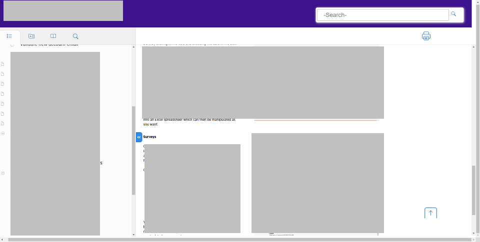

Explorer ,
Oct 21, 2020 Oct 21, 2020
I've created a new responsive layout, what I think you meant by a new skin in your last message. From there, I changed one thing at a time and verified each output before moving to the next. Each verification was expanding and contracting the window, minimizing/maximizing the TOC and again expanding and contracting the window to make sure the scroll bar did not disappear or freeze as with the last pictures I'd shown you. With the last change, I increased the bottom margin in layout.css at body.media-desktop div.topic, changed from 0 to 10px as back/forward nav links were being cut off, i.e., I could see the tops of the text, cursor changed to select hand but it wasn't the entire text being seen. This is the first of the results:
In this one, the TOC, indes and glossary tabs are on the side. One small pull to the right further and I get this:
Note that now the TOC, index and glossary tabs are now at the top. In addition, the visual presentation of the scroll bar is different, it's now significantly thinner than the first example.
Also note that the last line with back/forward text is completely gone. The disappearing back/forward line is not present in all pages but a significant number in my project. There is no consistency as to where the lowest line shows up when scrolled all the way to the bottom, sometimes it appears just above the bottom on the window, sometimes slightly above.  Here's another example where you can see the different text displays on the last line.
I don't know why this one change in layout.css should have been so destructive to my output, especially as I did it from within the Styles box in RH Classic.
Again, TIA for your help.
Oct 23, 2020 Oct 23, 2020
I hadn't realised you have been editing layout.css. Once you dip into editing that file you open a can of worms. It's complex and can easily break things. That's why I don't touch it. Sorry I can't help with that.
