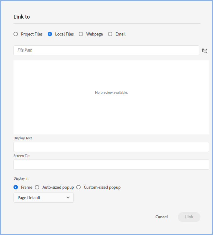

Here I have created a link by dragging a topic from the contents panel to some preselected text.
I could have done that by using the Insert Link icon in the top toolbar (paperclip). The result would be the same.
Note the Local Files option. You would browse to the source topic in Project 2 and that would normally create the relative link you want in the output.
The problem is that the relative path between your projects is not the same on the server as I understand it. Therefore after creating the relative path, you would need to amend to reflect how it is set up on the server. Personally I would set up my source projects to reflect what is on the server.
