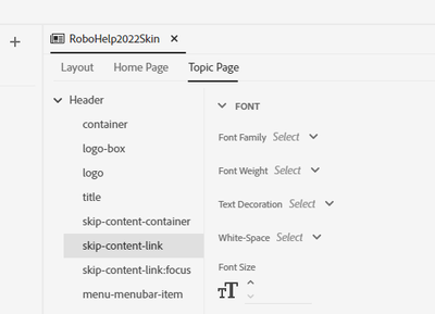

It is here in the RoboHelp Skin:
RoboHelp generates the link automatically.  It pulls in the path correctly, but does not append the help file name when the link is clicked from the server.  I have not touched the code.  It is auto generated by this property.  The only way to get to the link once generated is to tab and it will show up in the generated help.  When I look at the generated code I see this:
<a class="RH-LAYOUT-HEADER-skip-content-link" title="Skip To Main Content" href="#rh-topic">Skip To Main Content</a>

Mar 25, 2025 Mar 25, 2025
You were saying it was working on the local copy of the output - what does the link read in your local copy?
Community Beginner ,
@Jeff_Coatsworth it appends #rh-topic to the end of the URL.
