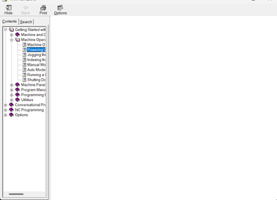

I've used RH2022 to generate Microsoft HTML Help (.CHM). Although I've spent quite a bit of time making sure everything is set up correctly, when I view the output, the topics do not display in the window (see the image below). I'm sure there must be a setting I'm missing, but I'm at a loss to identify it. Would appreciate any recommendations.

Is this the first time you're using CHMs in this location? Because CHMs on servers need some handholding to relax security on them to make them function (if that's even possible anymore). The sample project should be in your My Documents > My Robohelp Projects folder - if it's not there, then you can take a copy from the "factory install" location in your C:\Program Files\ folder - don't try to launch it from there - MS will usually shut you down due to security rights.

Ok, where are you trying to view the resulting CHM? Is the same thing happening with the sample project?

I would have expected Frameless & HTML5 to work - CHMs are antiques. Are you trying to view it locally or on a server? To determine if it's the project or some more CHM-specific malaise, try creating a CHM from the sample project and see if it behaves.

I'm outputting it to a network location. Can you tell me how to access the sample project you're talking about?
Mar 04, 2024 Mar 04, 2024

It looks like when I output the CHM to my local drive, it works. I think that's what I'll have to continue to do as long as we're still using CHMs. At some point in the future I believe we'll be transitioning to something more modern. Thanks so much for your guidance and patience.
It also needs to be installed on the local drive of the users.

It is no longer possible to work around the network restrictions. It's explained on my site.
