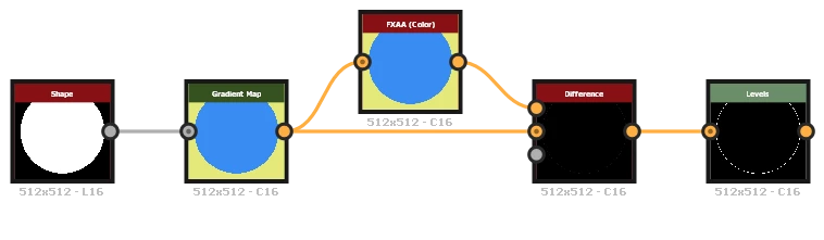

Hello @rboerdijk,
I can suggest two ways of approaching this: one uses a combination of Difference and Levels nodes while the other uses a custom function in a Pixel Processor node.
Connect the two RGBA images to a Difference node, then use a Levels node to bring the detected differences up to flat white.
In a Pixel Processor, sample the two RGBA images and subtract one to the other. If the result is zero (no difference), output black (0.0). If there is any difference, output white (1.0).
If you want to set a tolerance for the difference, simply check that the difference is lower than the tolerance value instead of strictly equal to (0, 0, 0, 0).
I hope this is useful!
Best regards.

Hello @rboerdijk,
Best regards.

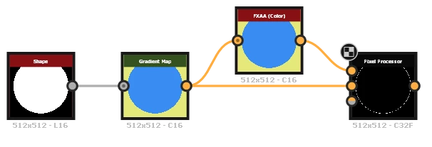

rboerdijkAuthor
September 24, 2021
Thanks, used the pixel processor and it works perfectly!
... and good call suggesting the lower-than tolerance, it indeed needed a bit of a 'fudge' value.
rboerdijkAuthor
September 24, 2021
Oh, in case anyone is interested, this is what I ended up using.
Note that I have 3 source images and tried to improve the result a bit by combining those.
