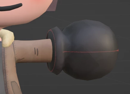

Hello everyone!
Here's my problem

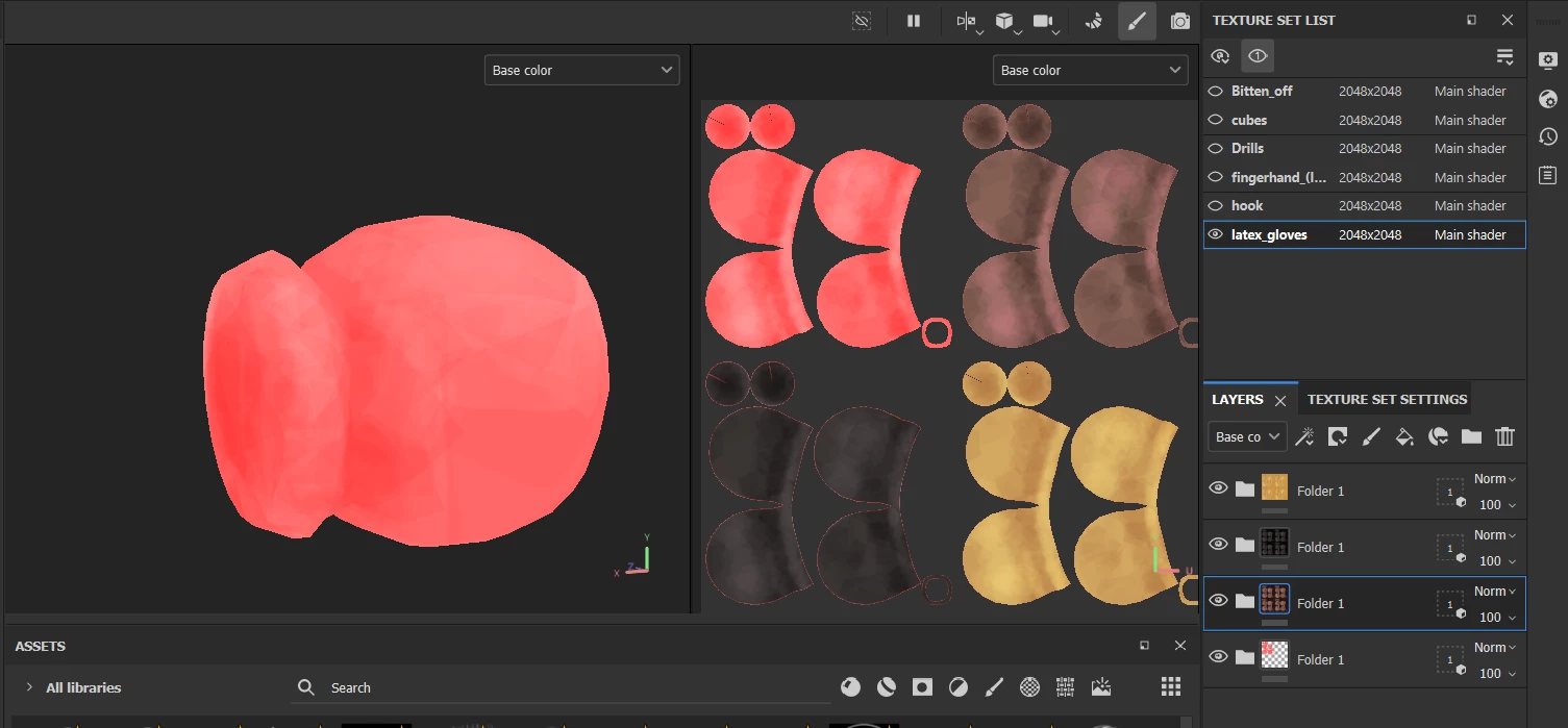

There is those red lines on seams of a model, and I don't know how to get rid of them.

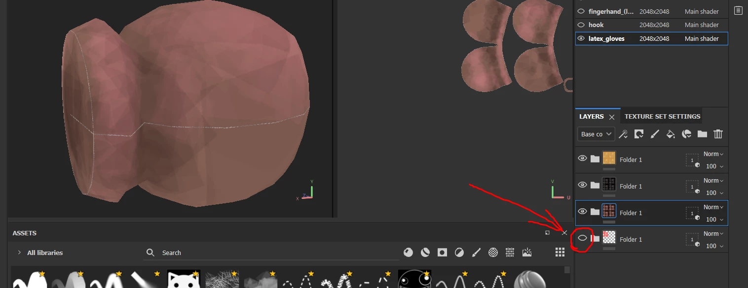

I guess, it somehow related to the first layer folder, which texture is red. And I use different models in same position, but with same material.
Even if I hide first red layer, you can still clearly see those blank lines on seams. How do I solve this? It is serious problem for me.
Even putting them in Blender doesn't help.
I beg you guys, please help.
I think this problem applies to texture due to its material wich contains multiple models in it. But how to fill those blanks?
Can not upload my file here  -_- . So I hope you understood my problem, and will try to find solution

Hello @Ilya Orchakov,
Thanks for the message.
We can even see the lines on the UVs in the 2D view. It looks a bit like Padding issues, but I am not sure that's the problem here. What was your workflow to select these areas? Would you agree to share your files, so I can take a deeper look?
