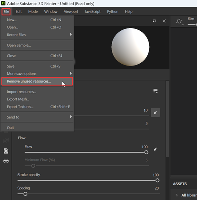

You can also try to remove unused resources.

okey so it's been a long time since, but if I remember correctly. The issue was because of a resource I had imported. I deleted all textures/alfas that I had imported, and reimported them. After that I could save the file.

For me, cleaning the shelf seems like the good workaround unfortunately. Out of curiosity, do your resources are in a cloud? It shouldn't bring issues, but sometimes the problem isn't where we thought.
