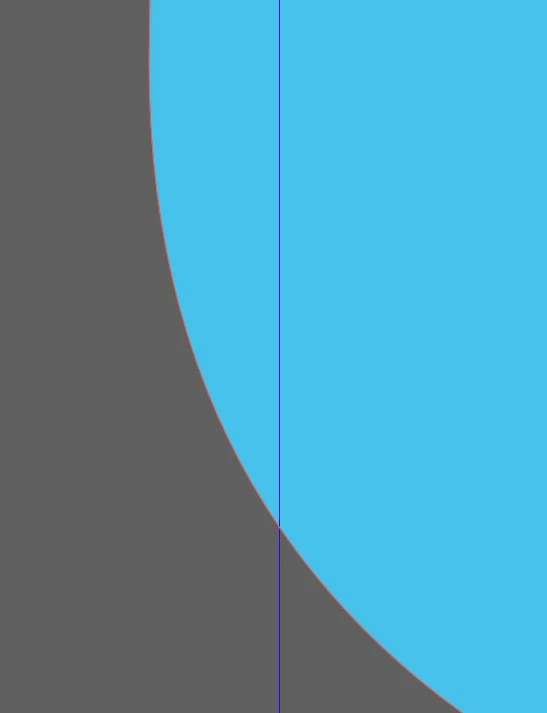

I created a pattern in Illustrator, when I export as a PDF a white line appears. How can i fix it?
It is important to note that this also happens with the patterns I created in the past, and there was no problem with them before, the problem appeared about a month or two ago.

Unfortunately, the problem is not in the display, it also appears in the print, on every pattern I create.
I have to solve this and I'm going crazy 😞
June 29, 2024
It goes right where the tile is

It is probably an anti-aliasing artefact, could be caused by the pattern not perfectly aligned to the pixelgrid.
Do they appear/disappear when zooming in and out?
You can also check your pattern tile size.
Set your units to pixels, double click the pattern in the Swatches panel and check if the Width/Height values contain fractions.
June 29, 2024
I did, it didn't work out 😞
