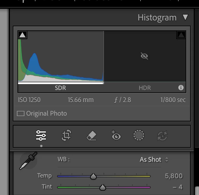

    Apologies for bringing up issues with the new version again. After extensive shooting tests and feedback from social media, I've confirmed that the final images in version 1.0.5 exhibit white balance drift (color temperature shifts toward blue, while tint shifts toward green). This occurs regardless of whether fixed color temperature/tint settings or auto mode is used.
    I'm currently unable to provide comparison photos, as both my phones have already been updated to version 1.0.5.
