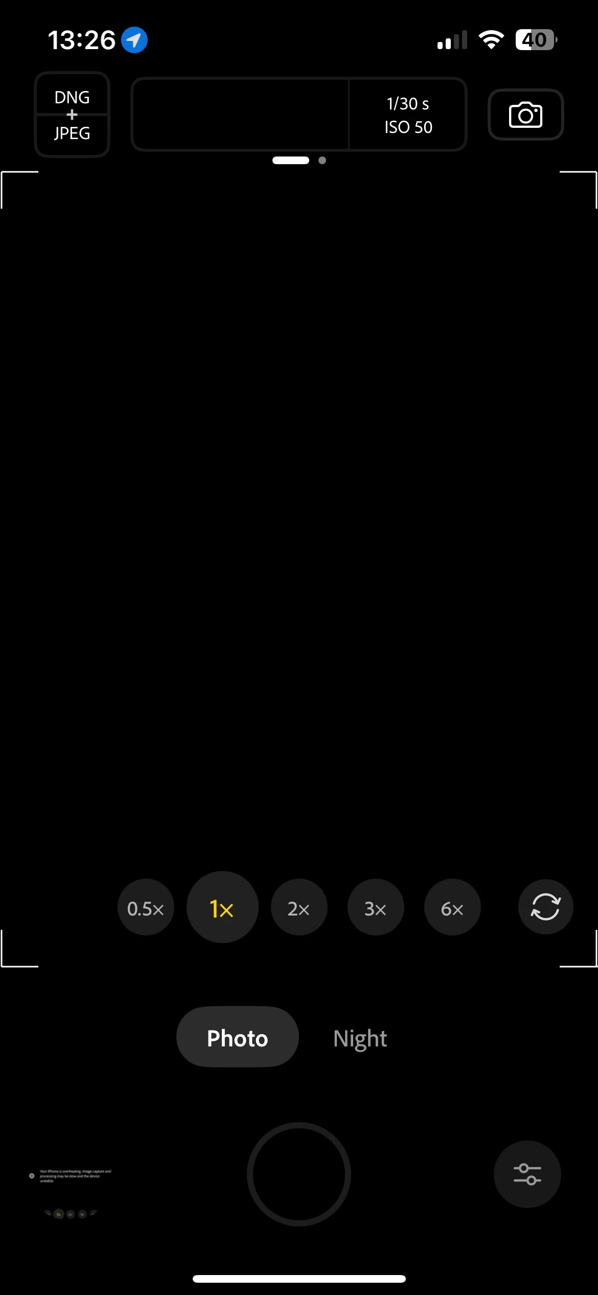

    Thoughts on the User Experience of the App
    Hi, I have been using Indigo now for a few weeks and here are my thoughts:
    1 - Long Exposure should be its own button, not hidden in "night" mode.
    2 - There should be an option to shoot DNG only, not just JPG+DNG
    3 - Macro Mode needs its own button
    To explain each further.
    1 - Long Exposure
    Maybe I'm a total idiot, but I literaly had to go onto youtube and watch an obscure video of a guy doing Long Exposure, because I could not find it anywhere in the app or on Adobe's own blog. At first I thought it would automatically do it, but eventually I found it. I haven't even tested the mode yet, as I couldn't find it while out near water.
    Having Long Exposure under Night Mode is unintuitive. I take Long Exposures day and night, so this is confusing.
    2 - DNG Only
    I use Lightroom App (which I love). There, LR stores the Raws in the app. I take a few photos and, when I'm satisifed I "got the one", I edit it and then export the JPG to my photos app. From here I share away. However, with Indigo, it's instanlty exporting all my photos to the photo app! This just clogs up the app with duplicates. Then, when I export to LR and adjust, I now have an edited and an unedited photo side by side. This is visualy frustrating, and it means I have to go back and delete everything. Please just give me an option for DNG only - I will then export my favourites to LR for editing.
    3 - Macro
    When in auto mode there is a button which turns Macro on. Same as the regular app. When in pro mode there is a focus wheel. But it doesn't seem to trigger Macro? I think this might be an Apple Hardware thing, but is there a way to add a Macro button in Pro mode? Or at least tell me if I am in Macro mode on the focus wheel?
    Aside from that, it's a nice app. I've gotten pleasing photos and it certainly has a place. I look forward to seeing where it goes.

    Hello - thank you for your interest in Indigo and for providing such thoughtful suggestions on improving the app! There is broad agreement on all 3 suggestions, and we will work on adding those to Indigo in future releases.
