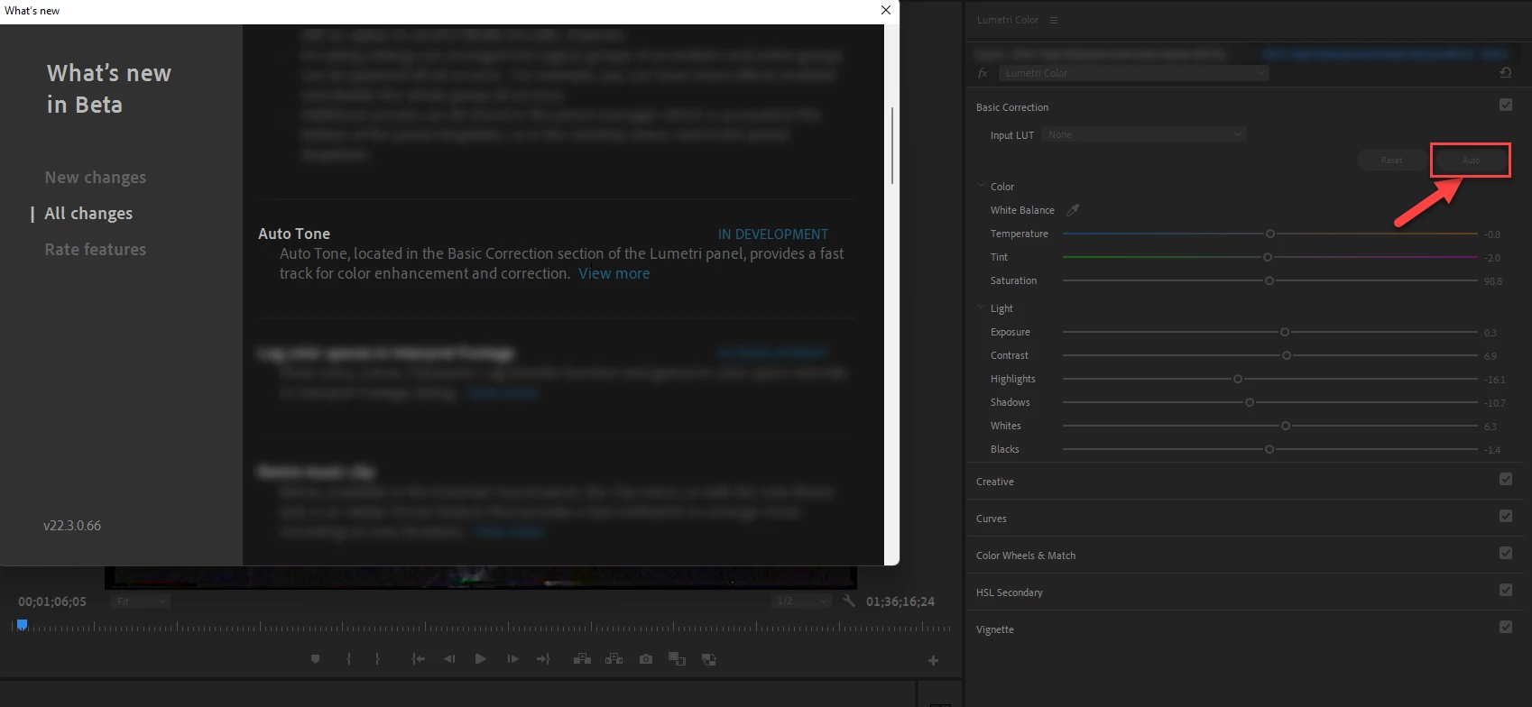

I recently downloaded Adobe Premiere Pro Beta 22.3 and don't see the Auto Tone feature:
R Neil Haugen
February 19, 2022
It's just showing Auto these days. It's the 'upgraded' version, but they seem to have dropped the "Tone" in the name.
