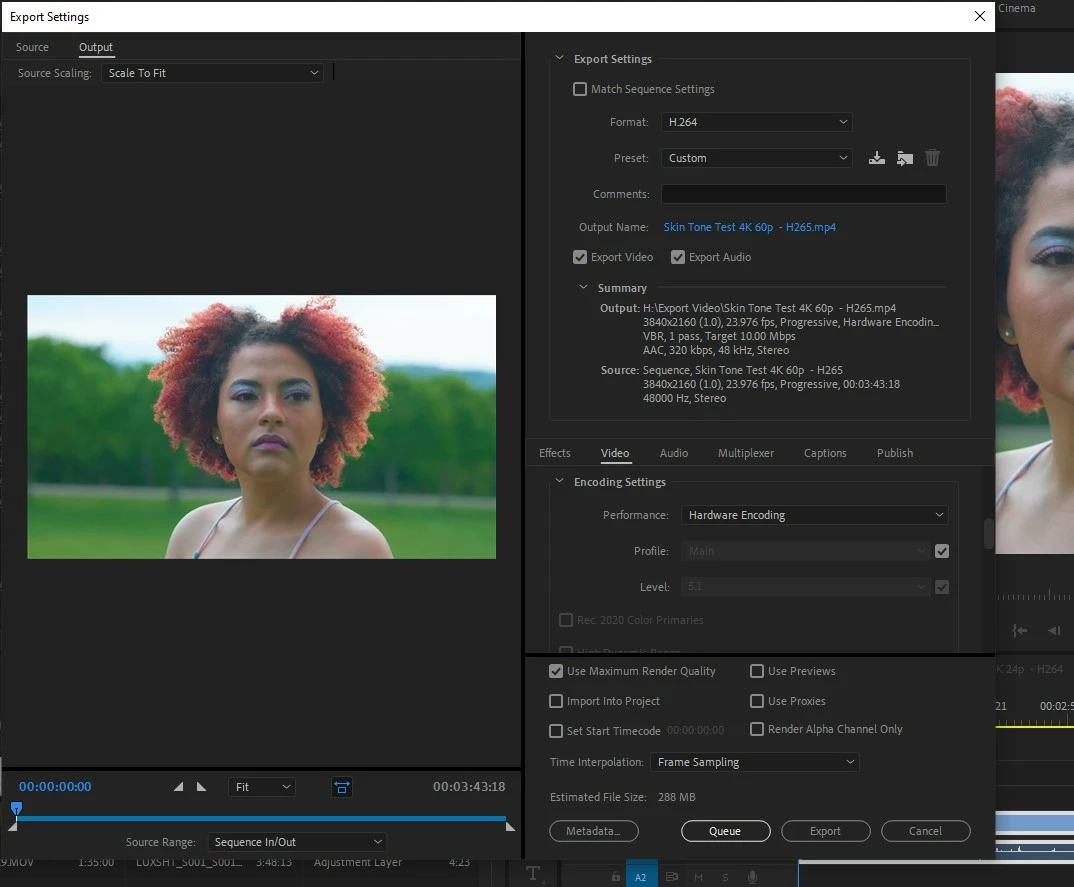

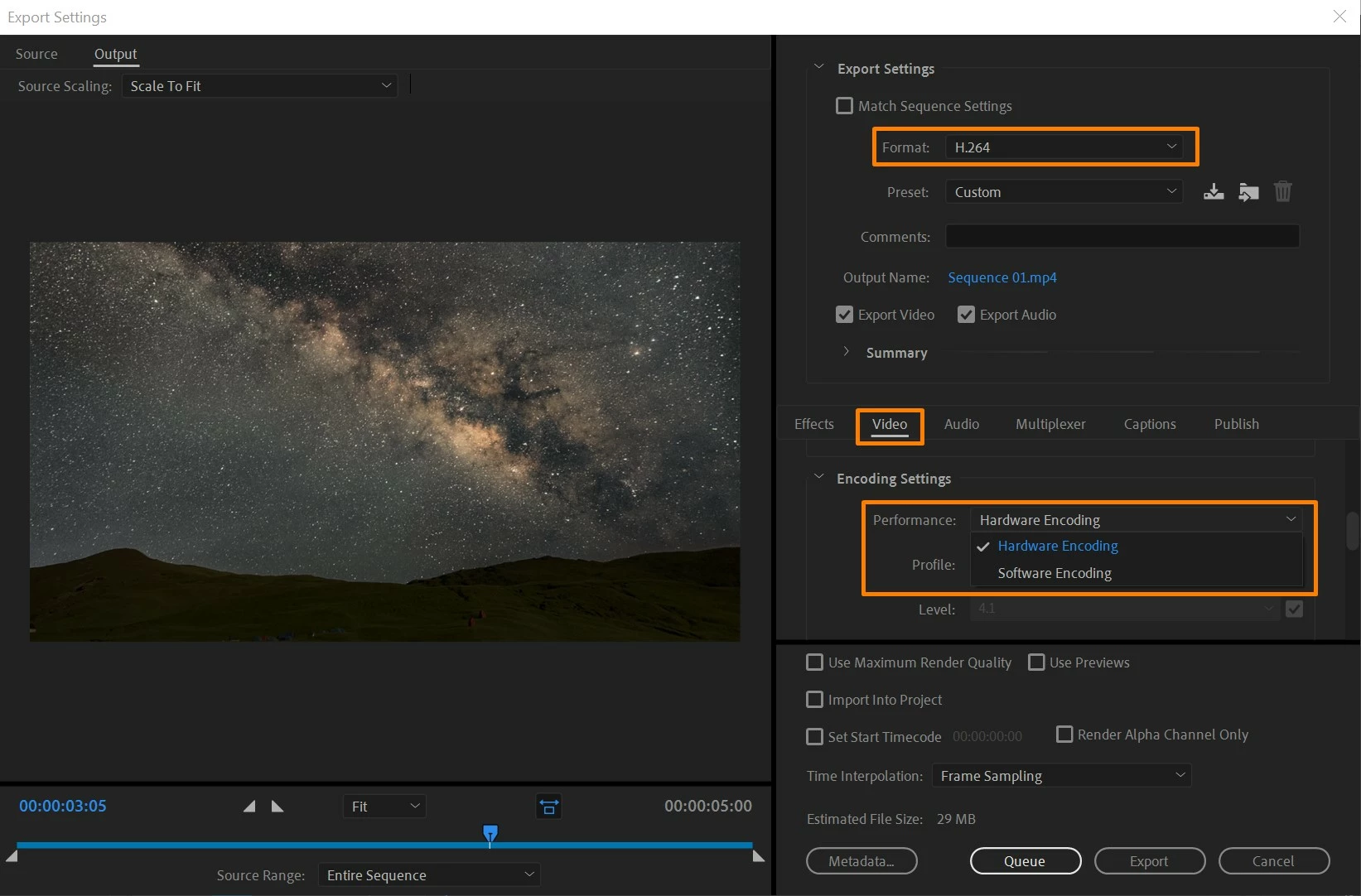

With the latest Adobe Premiere Pro Beta build we have enabled Hardware Accelerated Encoding through AMD GPU card.
If you have AMD GPU card on your Windows machine, you will be able to use this feature.
To enable this option, select H.264/HEVC from the Format drop-down under Export Settings. Then under the Video tab, go to Encoding Settings and set the Performance to Hardware Encoding. Setting it to Software Encoding will disable hardware encoding and Adobe Premiere Pro won't use AMD HW to encode the media. Please see attached screenshot.
Feature is enabled in Adobe Premiere Pro Beta, Adobe Media Encoder Beta and Adobe Premiere Rush.
Please try out the feature and share your feedback.

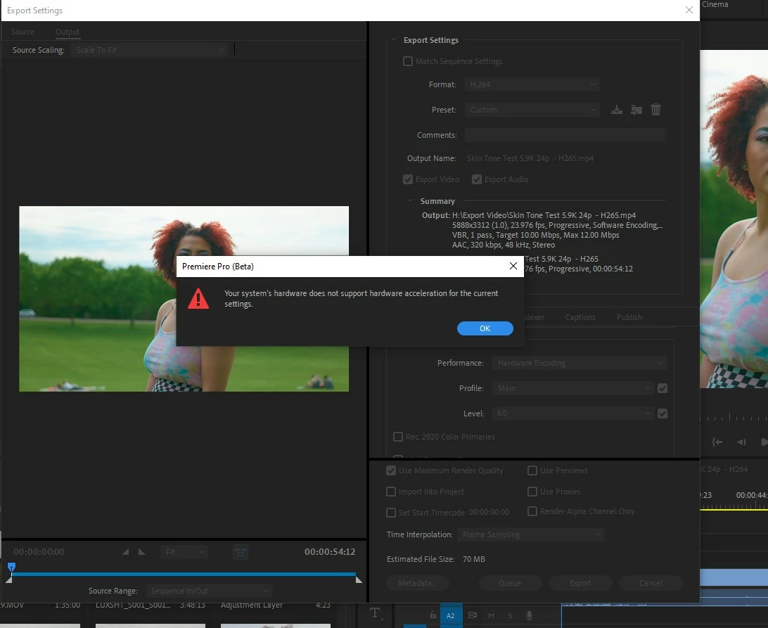

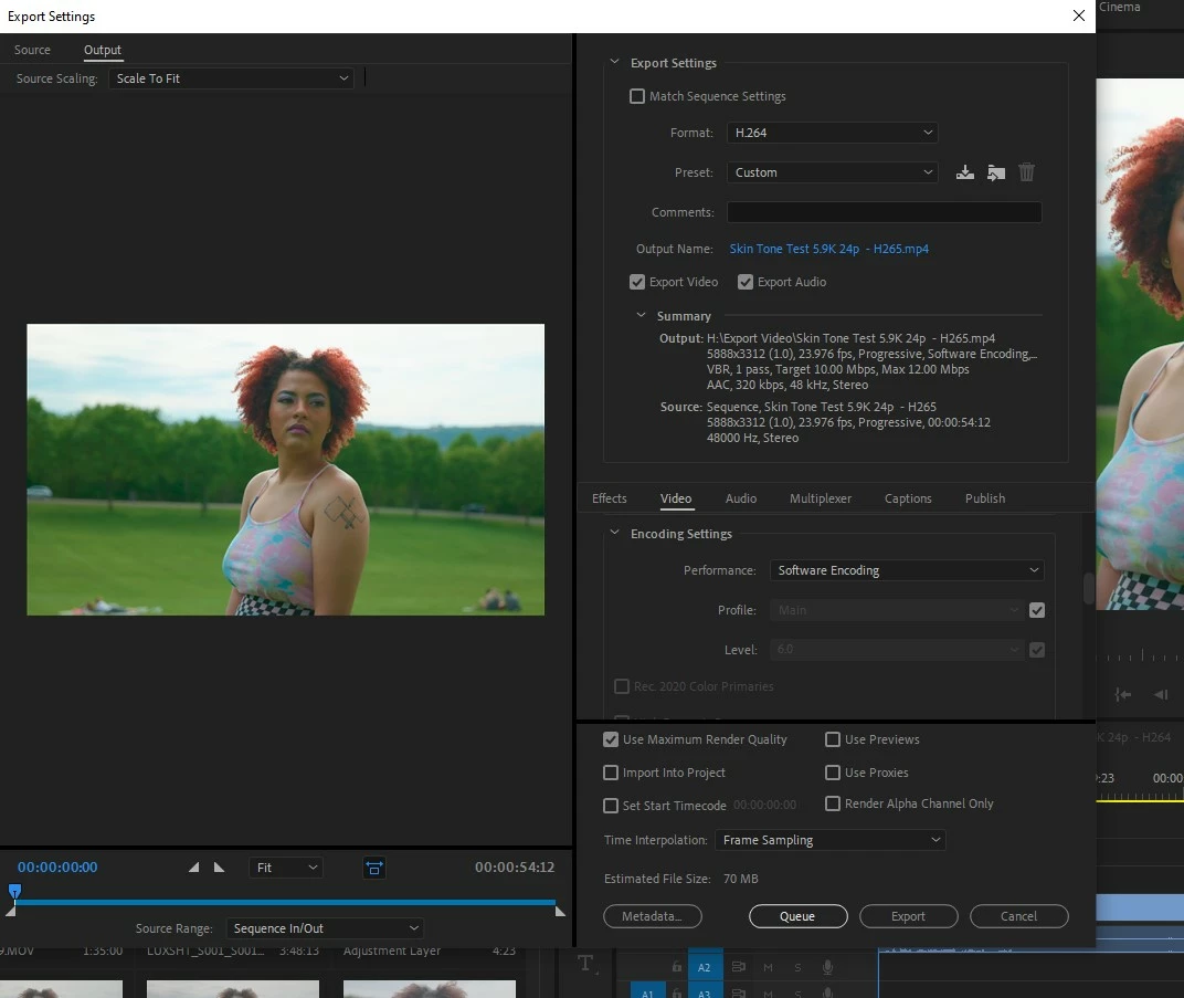

Hello Everyone!
I have found a bug! When I use my Panasonic S1H video camera and record 4K 10-bit H.264 5.9K 10-bit H.265, then encoding cannot be accelerated. I believe the system cannot processes the high resolution files.

Thanks for your query.
Yes, for  the high resolution files like -5.9K 10-bit H.265,  the encode will work via SW mode as HW encoding capability is dependent on the AMD card capability. For most of the cards tested, the HW encoding capability is till 4 K only and it can be more than that as well if the AMD card is capable. This is as expected.
-Regards

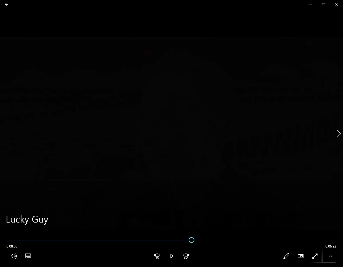

Seems like I spoke to soon!
When I reviewed the exported footage, there were errors. My project was recorded on the Panasonic S1H, and portions of the shoot were in 4K 10-bit H.264 4:2:2 and others were in 5.9K 10-bit H.265 4:2:0. The 4K parts encoded fine, while there is a massive exposure shift on the 5.9K files, to the point the screen looks almost entirely black!
After I reviewed the affected scene in Premiere, that scene had the same issue, so I don't think the problem is specifically GPU Encoder related, but it was how I ran into the problem nonetheless. Attached is a clip of the video playing back with the default Windows video player.
BrajeshAuthor
Apr 13, 2020 1:38 PM UTC
We are looking into it. We will let you know if we need any help from you.

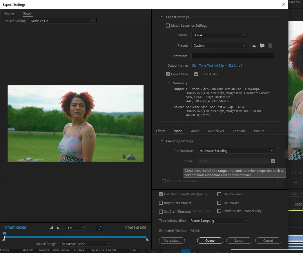

Apr 10, 2020 5:03 AM UTC
I was able to use this feature with my AMD Radeon Frontier Edition card and it worked great! My card has 16GB of VRAM, but GPU-Z only used just around 4GB of VRAM. Are you using the graphics card VRAM during encoding, and if so, why don't you use more of what the card has available?
