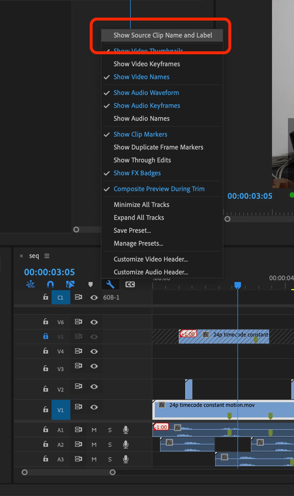

The feature Show source clip name and label is not visible nor in project settings nor in the wrench menu,..

That looks like you're not seeing the full list, there should be another couple/three up at the top I think. Huh.

Nope, I see the full list,..

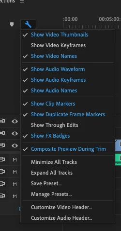

I am confused. The wrench toggle works nothing like the old checkbox.
Now, tf I go to label one instance of a clip in my timeline green, every other instance of that source clip on my timeline turns green. If I go to the wrench and toggle off "show label" then none of the instances show the label anymore. (BTW, the source name stays up either way).
But apparently, totally gone is the possibility to make one single clip on a timeline a different color from the other clips in the timeline, regardless of whether they are from the same source. That is what unchecking the old box used to accomplish. And that functionality seems to be gone from premiere.
Can someone explain how I can go back to taking one clip, or a chunk of selected clips, on my timeline and changing their color without changing every instance? This is a big part of my workflow. Thanks in advance.

This checkbox works exactly as expected on my end, it's identical to the original checkbox hidden in the menus.

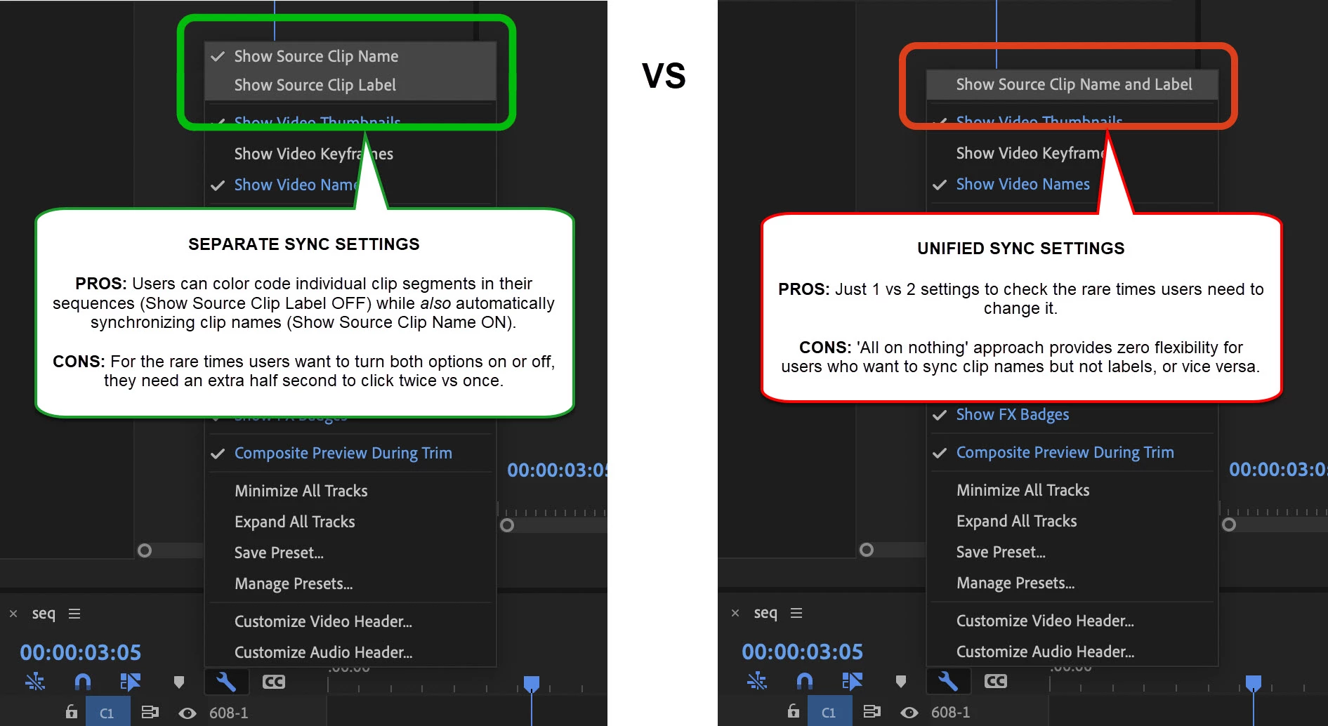

I agree with Pierre's latest post. Especially about the "4 states being easier for the user than 2 states".
As though the recent change is better than the old, being able to choose would be an even better upgrade to functionality.
There are many times when I want to change the name or label state of only one 'half' of the states stated. By state, of course.

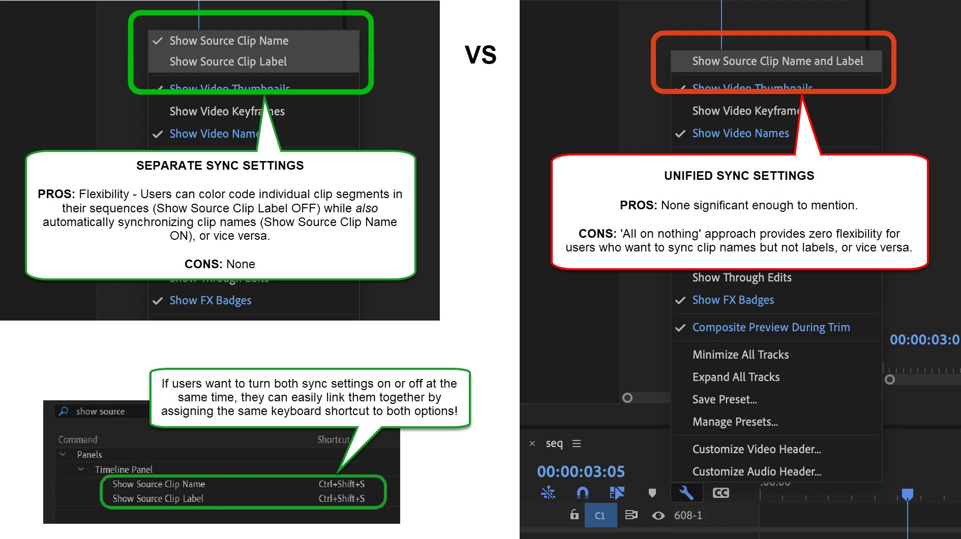

I think this illustration pretty much sums it up.
The only thing it leaves out are the pros and cons from the Pr team's perspective:
Separate Settings
Pro: would provide flexible options that respect the needs of all users
Con: takes more work to code in needed flexibility
Unified Settings
Pro: less work to code plus keeps new inflexible design 'consistent' with inflexibility of previous design*
Con: it remains an inflexible design
*To be fair, the argument of consistency (i.e. as Matt wrote: "aligns with how Premiere Pro has worked up until this point".) turns from a Pro into a Con when it is used to perpetuate an inflexible design.
Question: Does anyone need to change this setting on such a regular basic that the extra half second it would take them to turn 2 settings on/off vs 1 would actually outweigh the benefits of flexibility to all other users?
I'd love to hear other people's thoughts regarding this.  Thanks!

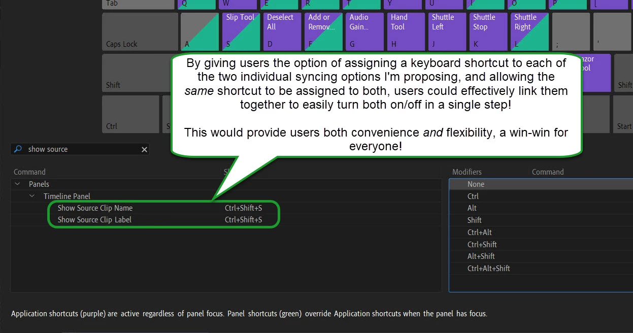

"This change means you can easily toggle this view setting via a keyboard shortcut."
I just realized that there's a simple solution that would make it possible for users to toggle both separate settings I suggest on/off at the same time, thus providing both convenience and flexibility at the same time:  Give users the option of assigning a keyboard shortcut to each of the two individual syncing options I'm proposing, and allow the same shortcut to be assigned to both, thus effectively linking both options together so users can easily turn both on/off in a single step!
This would effectively remove the only true Con for Seperate settings and the only Pro worth mentioning for the current unified setting.  Here's an updated illustration to show the changes:
Note: If a user has one sync option on and the other off, and they use an identical keyboard shortcut that turns both settings on/off, then in this rare situation the toggle could simply default to turning the off option to on, before toggling both options off when the shortcut is pressed again.
What do you think?
BrianLevin
Apr 4, 2021 10:59 PM UTC
I'm in favor of Pierre's suggestion but totally understand if it means a programmer spends time doing this vs. fixing problematic bugs or improving the software stability, I'll take that instead. While I wouldn't personally benefit from separating these values (especially if it's now keyboard mapable to on/off this checkbox), I can absolutely see how you would especially as an editor who does a TON of turnover work and VFX editing.

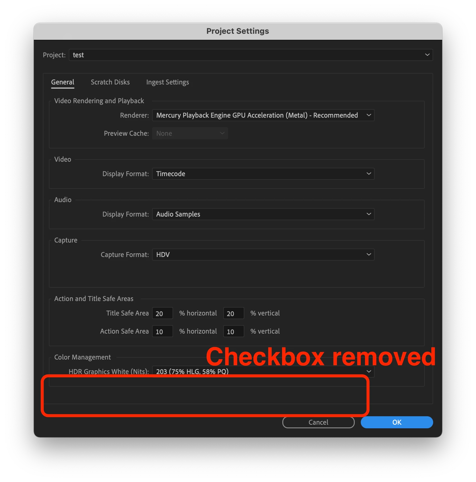

I like that this has been removed from the Project settings, but I do understand why some want Label Colors and Source Clip Name to be separated.
