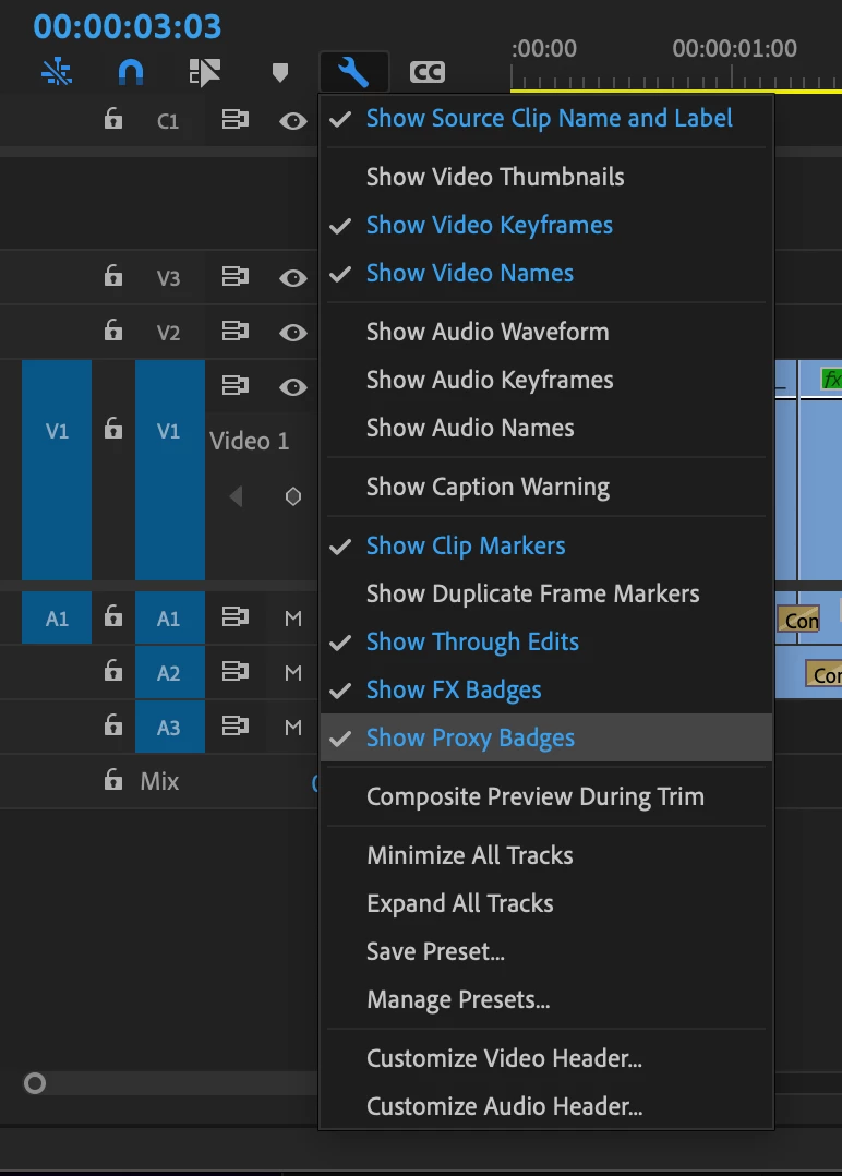

The badges will appear by default upon proxy creation. To turn these off, you can deselect “Show Proxy Badges” in the sequence’s wrench menu.

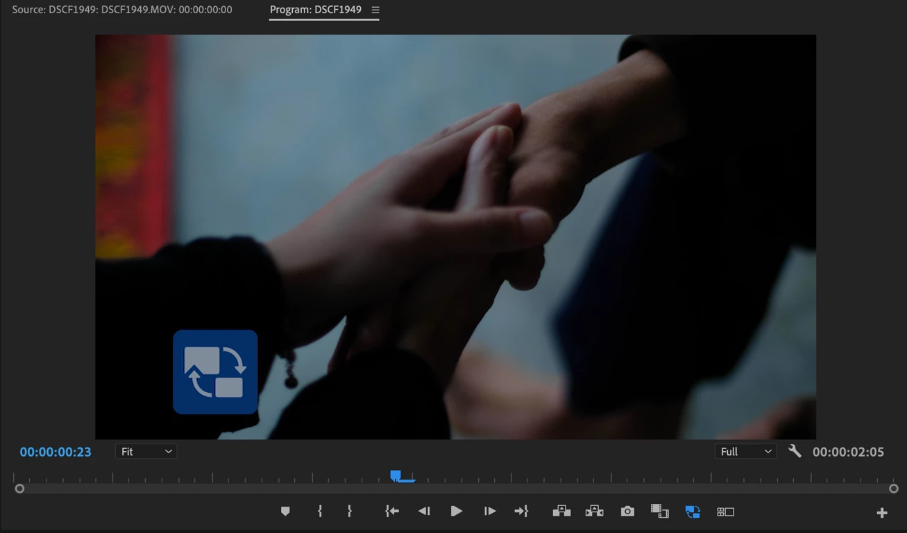

Watermark: Added to proxies at creation
We’ve made it easier for users to add watermarks to their proxies.
This handy feature is in the “Create Proxies” and Ingest “Project Settings” dialog(s).  Adding watermark will be off by default, but once checked it will be sticky for future use.
There will be a visible watermark in the lower left corner of the frame.  This is only on the proxies. When proxy playback is turned off, there will be no watermark present on Original Camera assets.

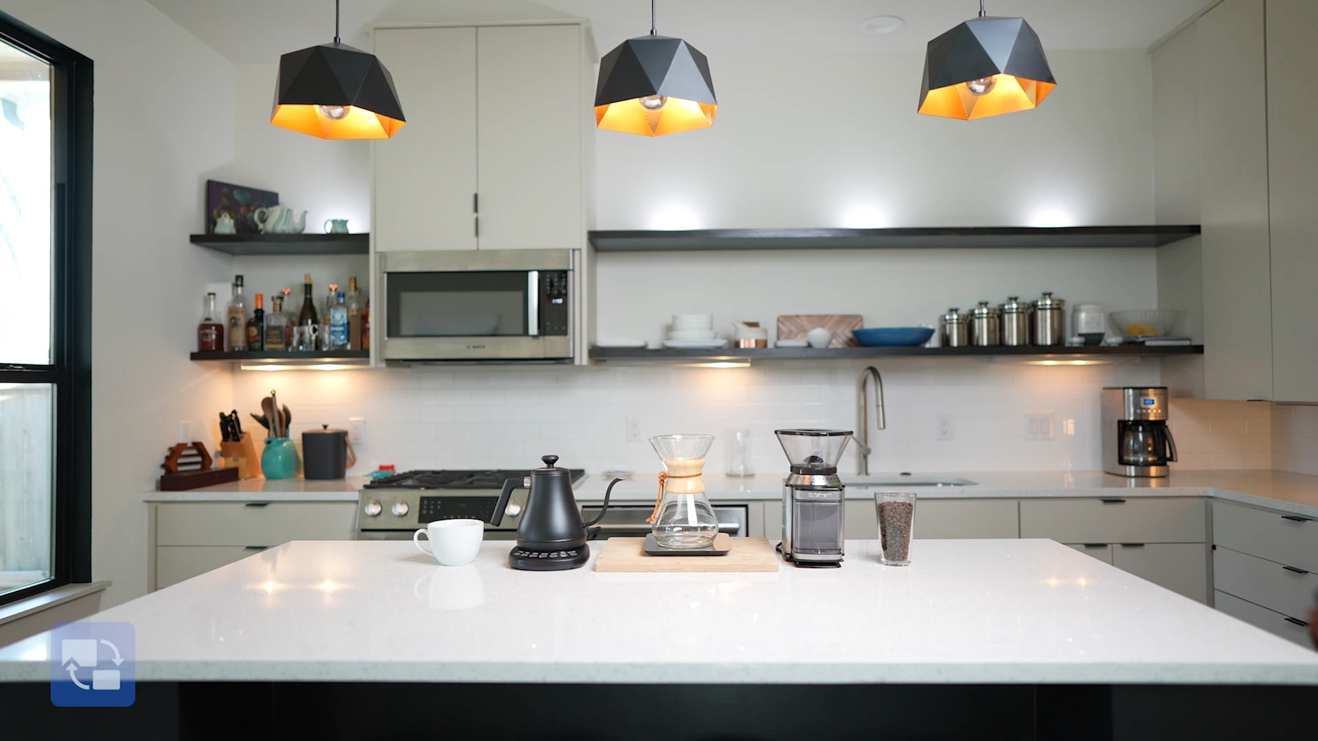

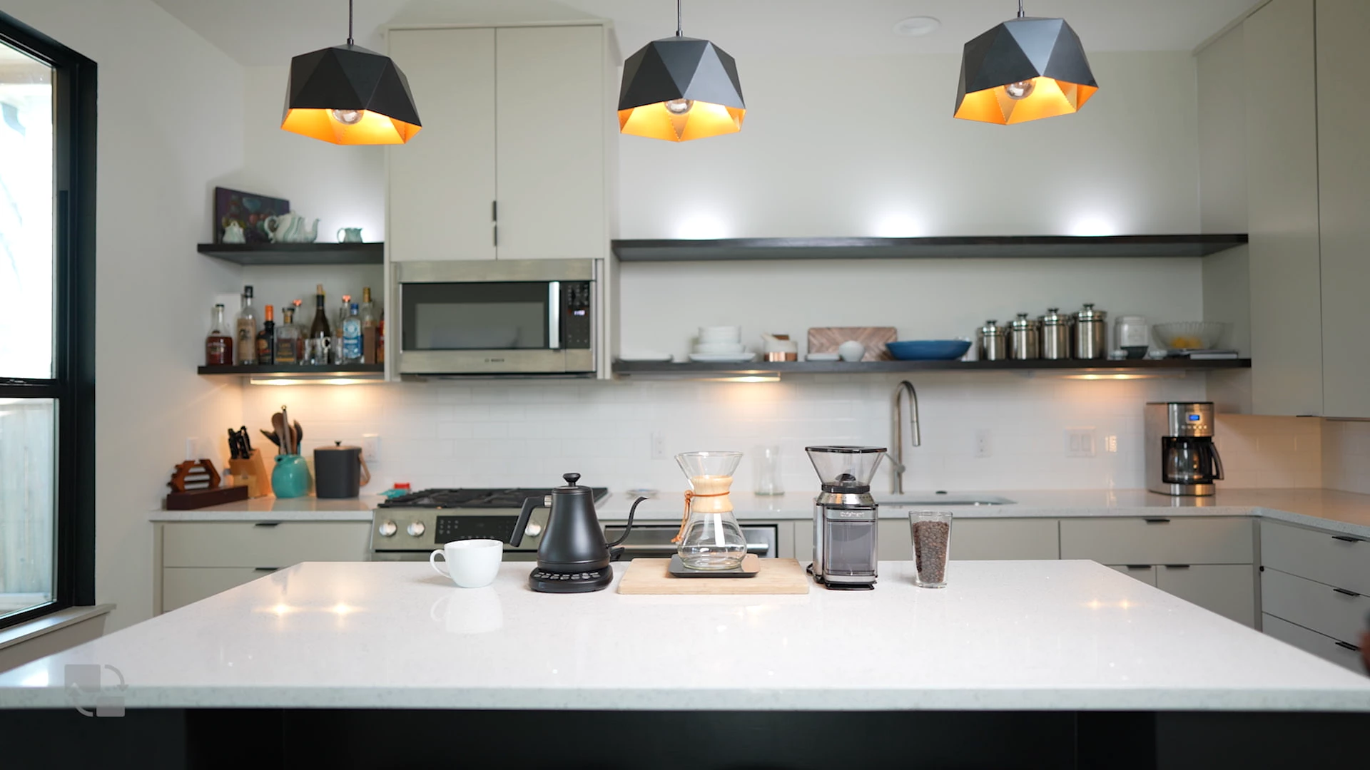

We made some adjustments to the watermark.  We felt the watermark was too prominant and distracting so we removed the blue box and dropped the opacity.  Most of the time you shouldn't notice it while editing, but if you look for it, it's there.  Any feedback is welcome.
New style
Old style
May 24, 2022 11:32 AM UTC
I like the new dimmed proxy watermark. Thank you for making proxy usage more streamlined!
