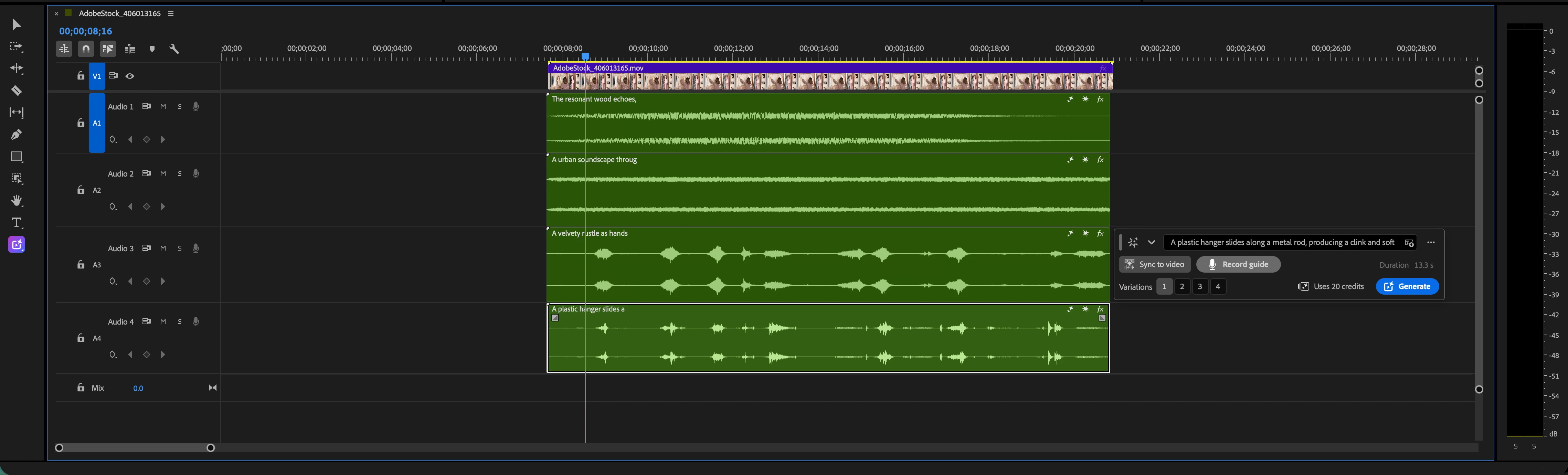

Select a range in your timeline and Premiere "listens" to the picture, then builds a soundscape that moves with it. It creates two background layers and two foreground layers, all landing where the action does. And you're not stuck with one baked-in mix, you get four editable stems. Regenerate a layer until it clicks, nudge one that's almost there, or rebalance the whole thing.

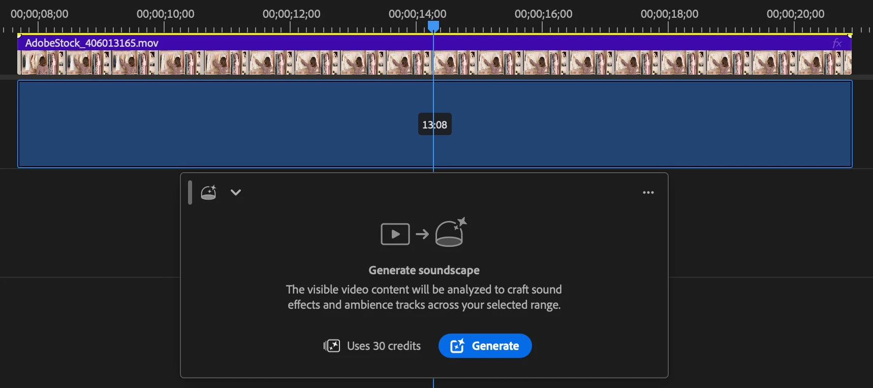

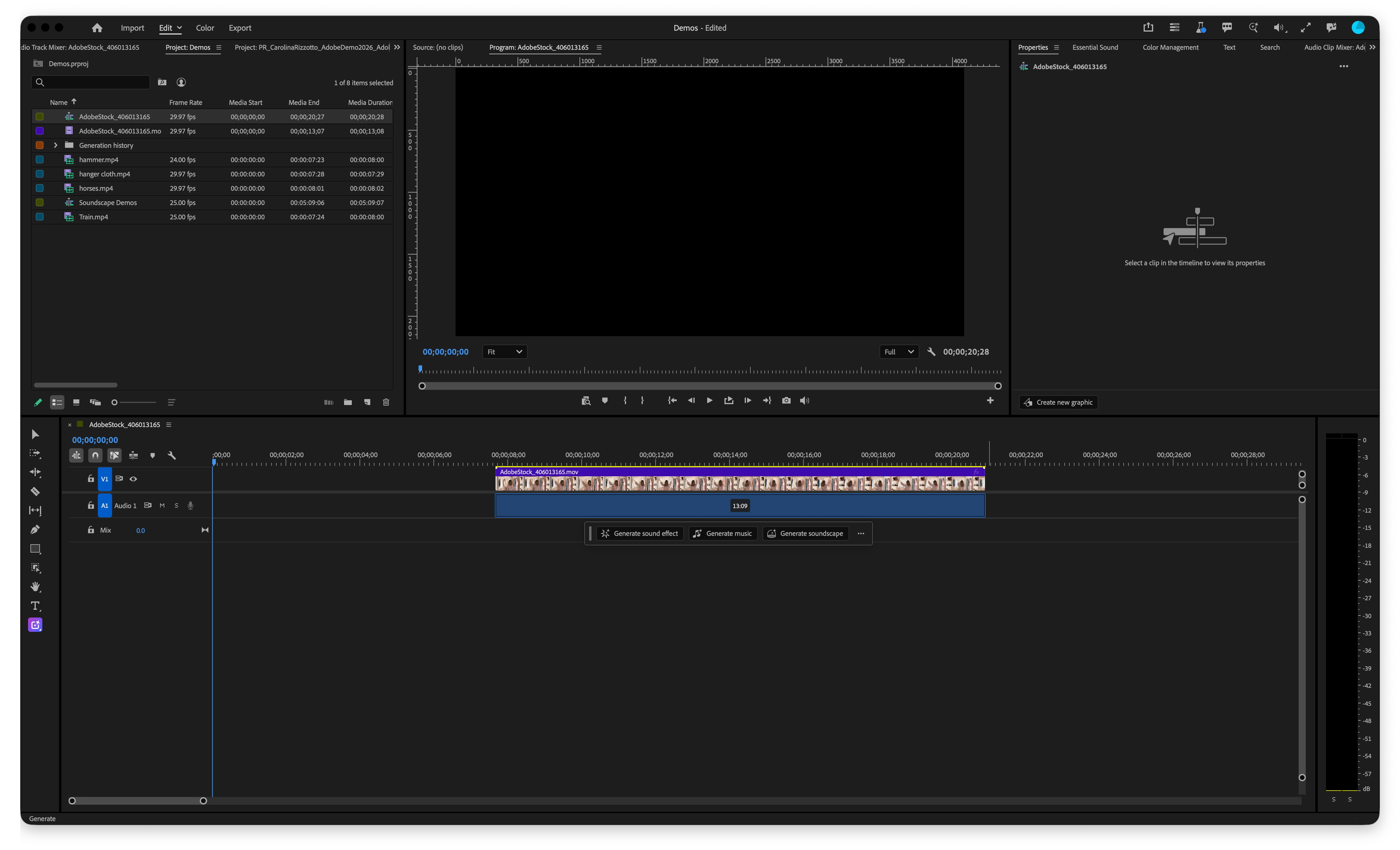

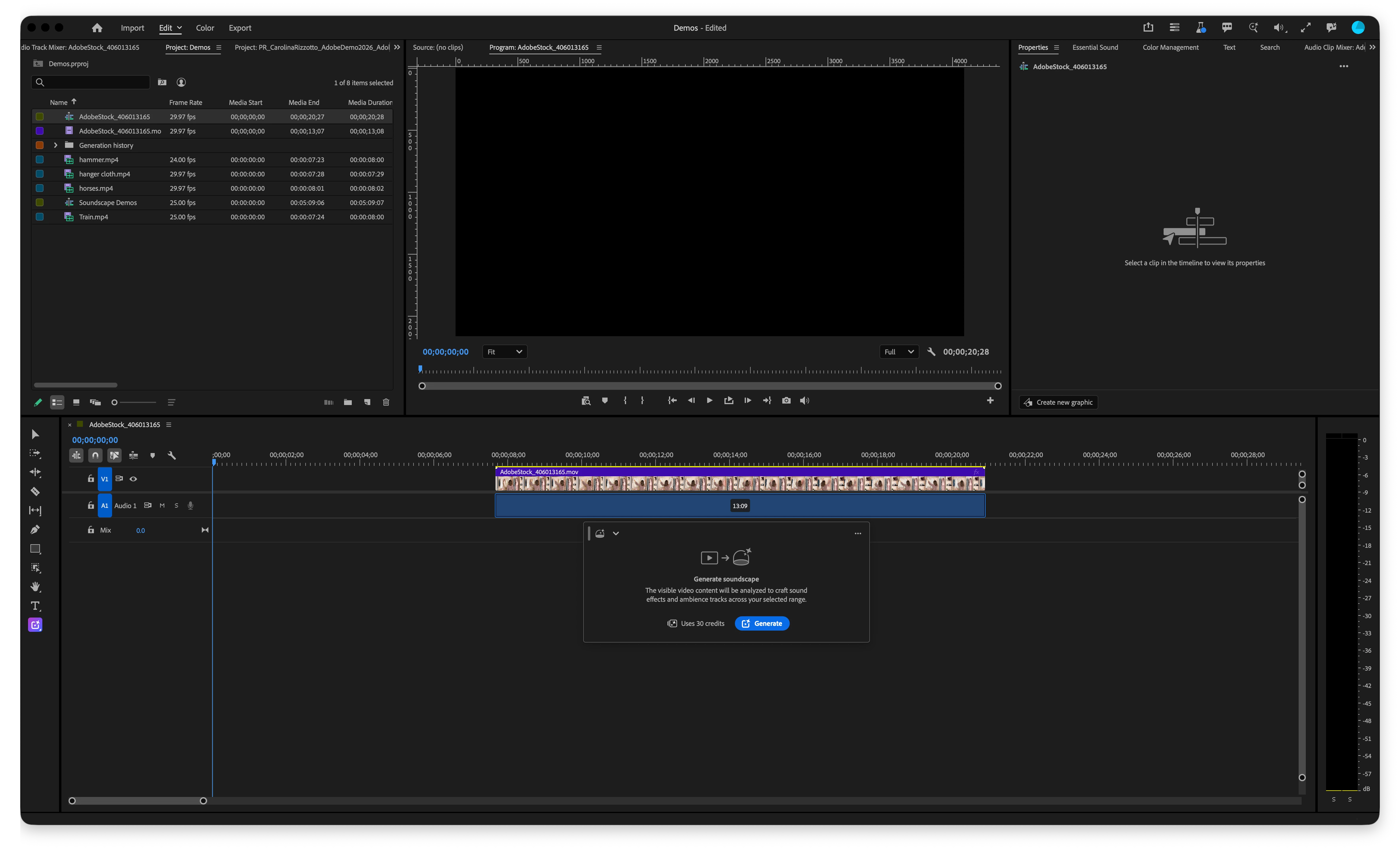

Drag a range selection on an audio track and the Generate Soundscape option shows up. Set it over the section you want scored, run it, and the layers drop into your timeline as stems you can edit like anything else.
Generate Soundscape as part of the Generate Media Tool options

Soundscape provides 4 stems with 4 variations each
