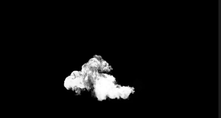

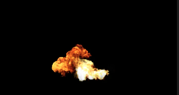

Composite Video view of a frame of sample media in Program monitor
Corresponding Red channel view of same frame of sample media in Program monitor

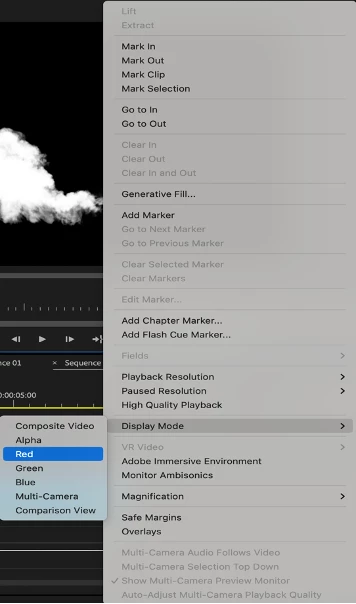

Perform Right click within monitor window and then choose Display Mode > Red/Green/Blue channel based on requirement.

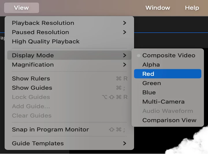

Keep the relevant monitor window in focus, navigate to top menu bar, and then choose View > Display Mode > Red/Green/Blue channel based on requirement.

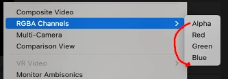

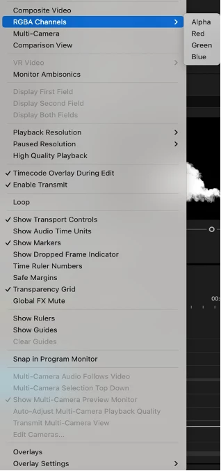

4. I also notice that the order of the channels is not in line with the way it's named. You say RGBA but the options in the list is ARGB.  RGBA is the common order used everywhere else so it would make sense to swap those in the menus.
5. In the wrench the option is called RGBA channels, separating it from Composite Video, Multicam etc. I get the idea but perhaps it makes more sense to just call it Channels? If in the future some form of multiple info channels become supported, calling it RGBA wouldn't cut it anymore.
Example from Resolve:
6. It would make sense to put "Composite Video" (which I already suggested to rename to "RGB") inside the channels menu at the top (as seen in Resolve or After Effects) because it belongs to the same group/principle. Multicam and Comparison view are a different thing all together.

I agree with point 4, but in point 5 I would recommend against just calling it "Channels" as this could be assumed to mean audio channels, the way WAVs are viewed in the source monitor.  "Color Channels" or "Individual Color Channels" would be good, although I am not opposed to "Individual RGBA Channels" as it is very clear and specific.  For 6, I think "Composite Full Color Video" or "Composite RGB Video" is good to have outside the color channels menu, so it is easy to find, but I can also see the value of consistently keeping it in "Display Mode" to match the other two places it can be selected.  But "Display Mode" is very generic, so a clear visual communication that it is in single channel mode, that offers an easy way to switch back to Composite RGB, without searching through any of these menus, seems important to offer to the 90% of users who aren't ready to fully take advantage of this new advanced capability.

I get your point on the "Channels" name. However "Color Channels" would still only encapsulate RGB/A. If there is no desire to come up with a name that futureproofs it, I'd be fine with keeping the RGBA Channels naming instead 🙂

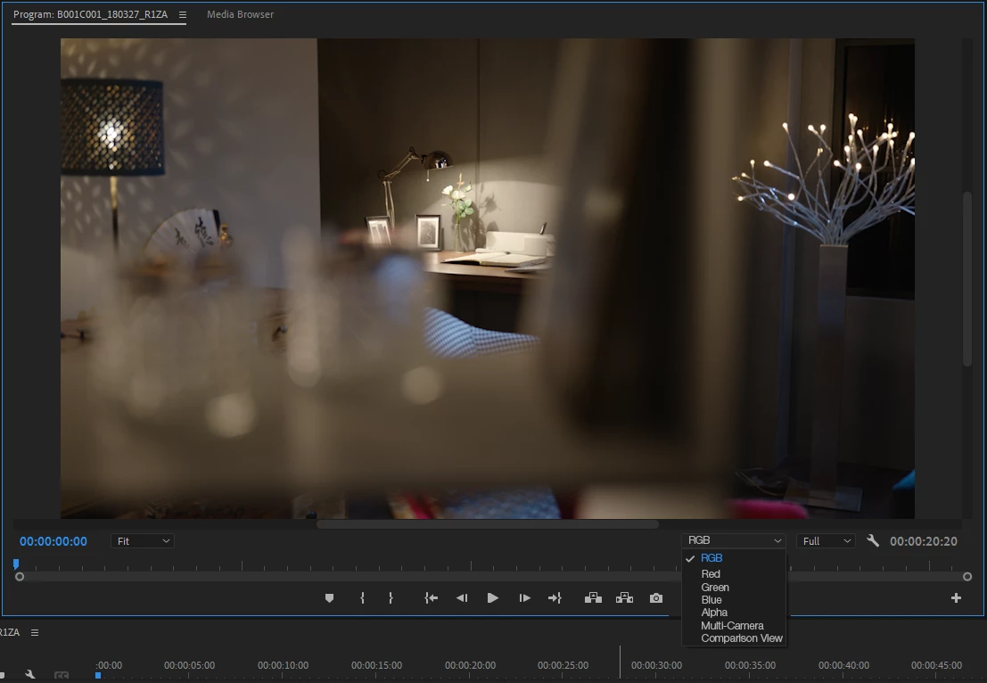

1. It is not visible which channel is currently enabled. Perhaps a similar approach to After Effects is practical with a border of Red/Green/Blue or white for Alpha to indicate that that channel is currently enabled. Additionally/alternatively, since there is lack of awareness, adding some form of permanent text based info on which display mode is enabled below the viewer where timecode/zoom/playback res is located is required. Maybe a dropdown menu next to scale on the left or next to playback resolution on the right? This would also remove the need for navigating that massive wrench/right-click menu. (aside from assignable kbd shortcuts).
Example:
