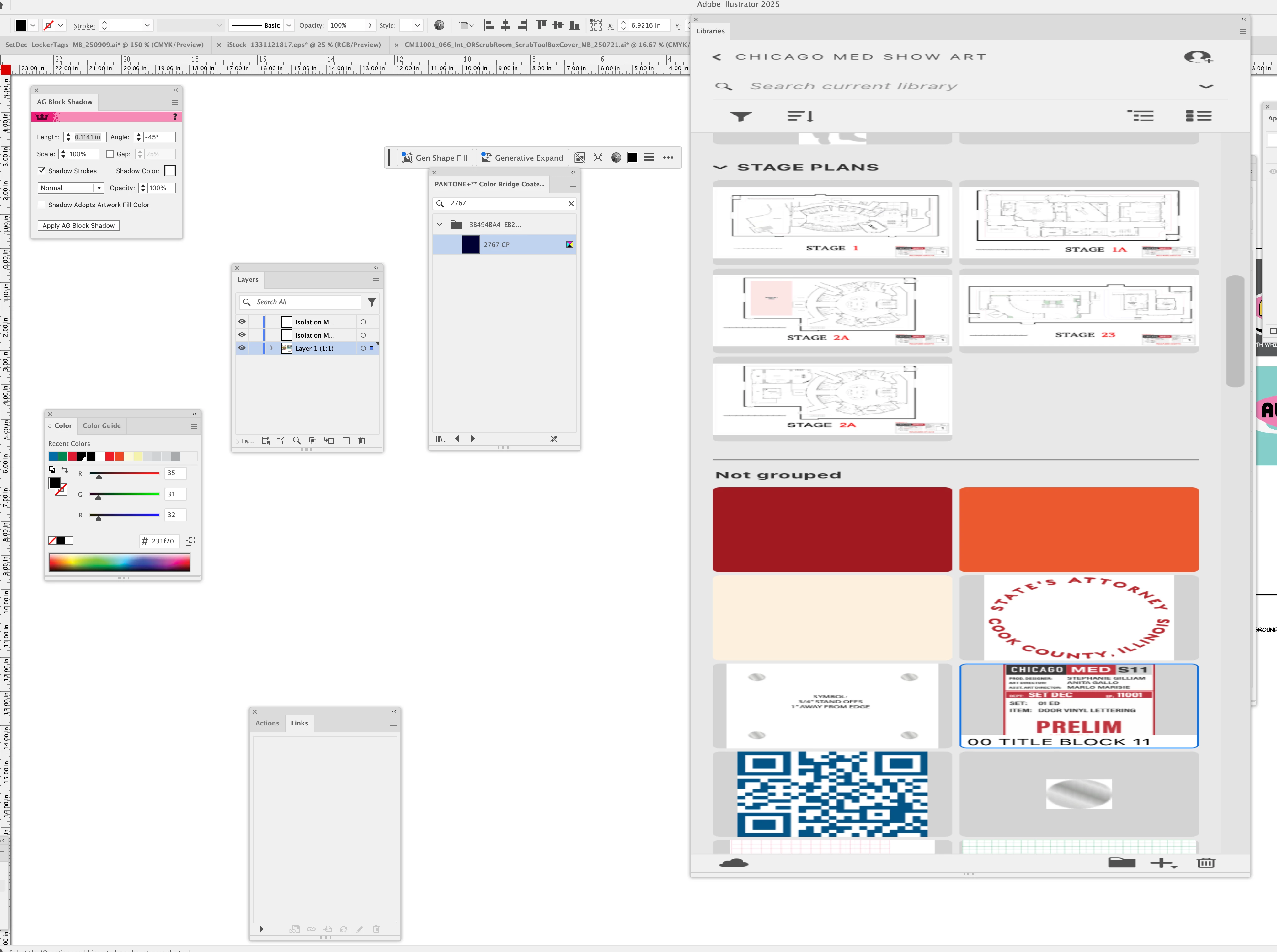

InDesign CC Library Panel freezing, inactive and stretches on expand like it's a flat jpeg
I heavily rely on the CC libraries for speed of CRE book productions. The CC library InDesign panel becomes inactive and freezes. When expanding the panel it streches like a flat jpeg. The troubleshooting either does not help or gives temporary relief for a couple hours tops. I shouldn't have to log in/out of Adobe to get the CC library panel to work for a limited amount of time.

This just happened to me again, for like the third time. Library panel is completely unresponsive and if I try to adjust the window, it stretches as if it's a jpg that had been place on the page. It's bizarre. It's annoying. I'm sick of seeing it.
