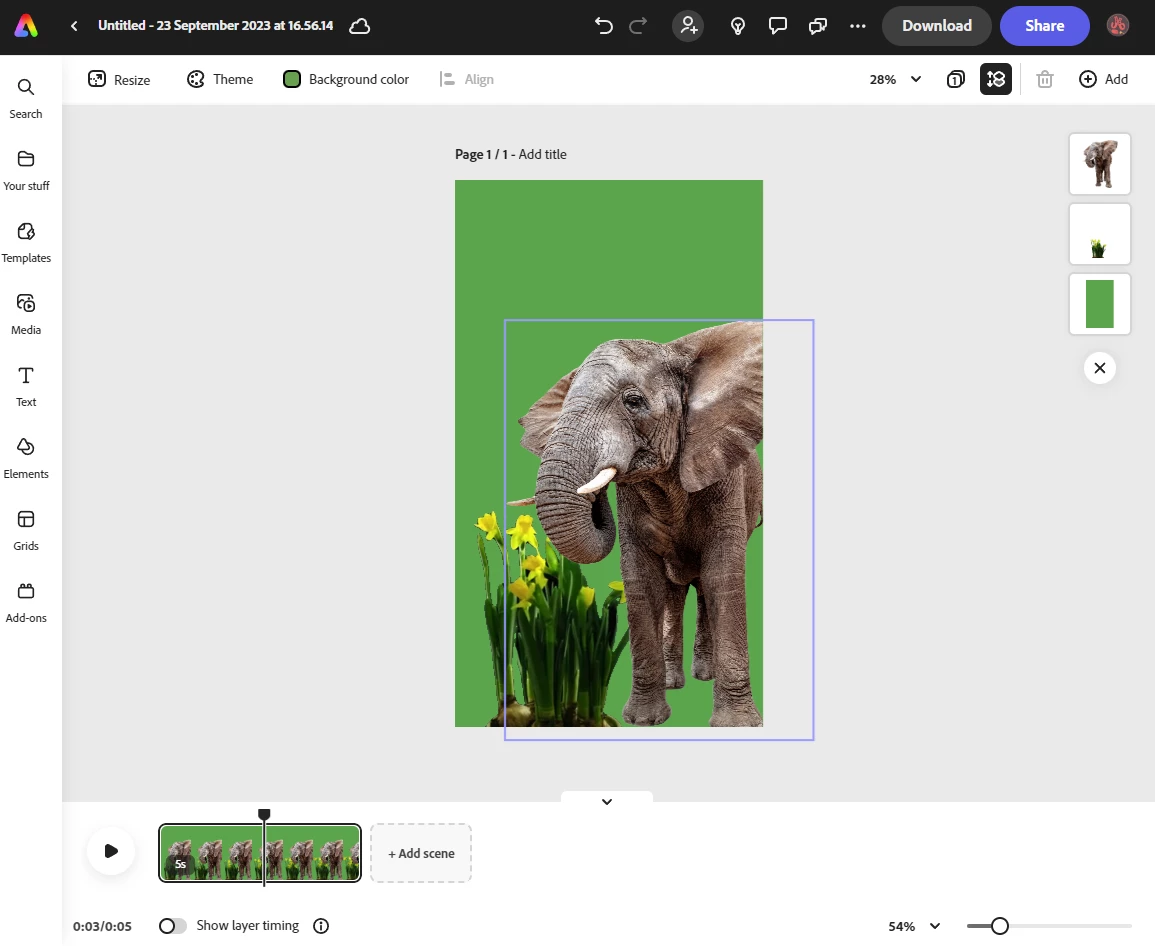

So for what you want to do you need to use the layer stack to organise everything:
1. Green screen background - either use background colour or have a shape filling the layer - at the bottom
2. Video - second layer - flowers
3. Animal - top layer - elephant
A very rough project to show you what I mean:
To move the layers drag and drop them in the layer stack on the right-hand side. Here's a video about using layers - sorry in English because sadly, I am not multilingual 😕😕
