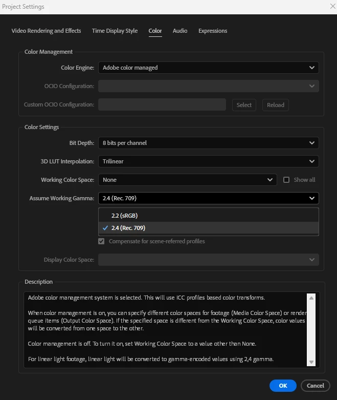

Oh, I finally figured this out!.
If your comp looks right in AE but dull/washed-out after sending it to Media Encoder — it's a gamma mismatch, not an export bug.
Dynamic Link expects Rec.709, which is gamma 2.4. Fix it in the project, not the export: File → Project Settings → Color and set Assume Working Gamma to 2.4 (Rec. 709). This makes the queued render match a direct export.
