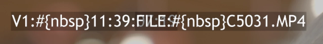

#nbsp on burn-ins coming from Premiere
Steps to reproduce:
    1. Apply Metadata burn-in in Premiere
    2. Send sequence to MediaEncoder
    3. Preview the preset in Premiere
Result: Timecode burn-ins have #nbsp at the head, but this does not appear in Premiere.
Expected: See the burn-ins as they exist in Premiere.

Last Monday, I successfully exported two timelines with an adjustment layer on top, carrying the Metadata & Timecode effect. I usually copy the adjustment layer from the previous project, so I don’t have to change the settings.
It’s been 17 days ago since Premiere and Media Encoder were updated, so nothing changed in between last Monday and Wednesday (today).
I just tried to export another (similar) timeline from another project, also including the adjustment layer, and this time around, I encountered the {nbsp} issue as mentioned in this post.
The timeline needed to be exported right away, so I disabled all the labels, which seemed to be a temporary solution. Preferably I would still be able to use the labels.
I also tried to create a new adjustment layer and attach the Metadata & Timecode effect to rebuild this first line. But still, Media Encoder messed up the line and showed the {nbsp} spaces.

I was having the same issue on the public version of 25 and after trying to trouble shoot it by trying loads of different settings. I found that if you go media encoder>settings>general and under Premiere Pro and tick the checkbox for 'Import sequences nativley' then it exports the sequences as you see and export in Premiere.

I had this exact problem when exporting with encoder, and found that the problem went away when I directly exported from premiere (v25.0.0)

I had the same issue on 24.5.0 (metadata shows well during play out and export in Premiere, but has the nbsp error on all clips in Media Encoder), and for me it had the following origin;
At one time during the editing process, I imported part of a sequence from another project. That project seemed to come from a newer update, maybe it was even downgraded. All source files were the same, with a different timing in its clips. One audio file however, also had a standard power fade added, which I believe was the culprit. This happened via Media Browser as well as via copy-paste while having both projects open at once.
The solution for me was just removing that fade. For someone else removing all clip effects [Remove Attributes] on specific parts may work when the origin is unknown.
