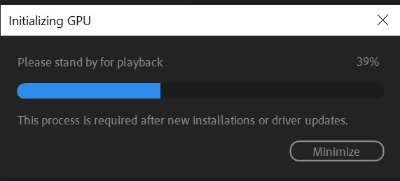

Upon opening the current release of AE I was shown this, it was stuck at 40% for a while, it took around 5 mins to complete

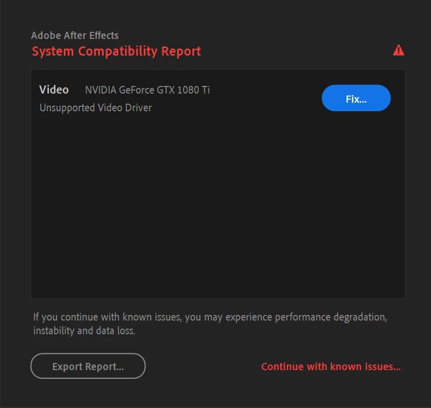

Update: I have just rolled back to 526.98 from November 2022, and as soon as I started AE I received this warning (the reported issues are also still present):
