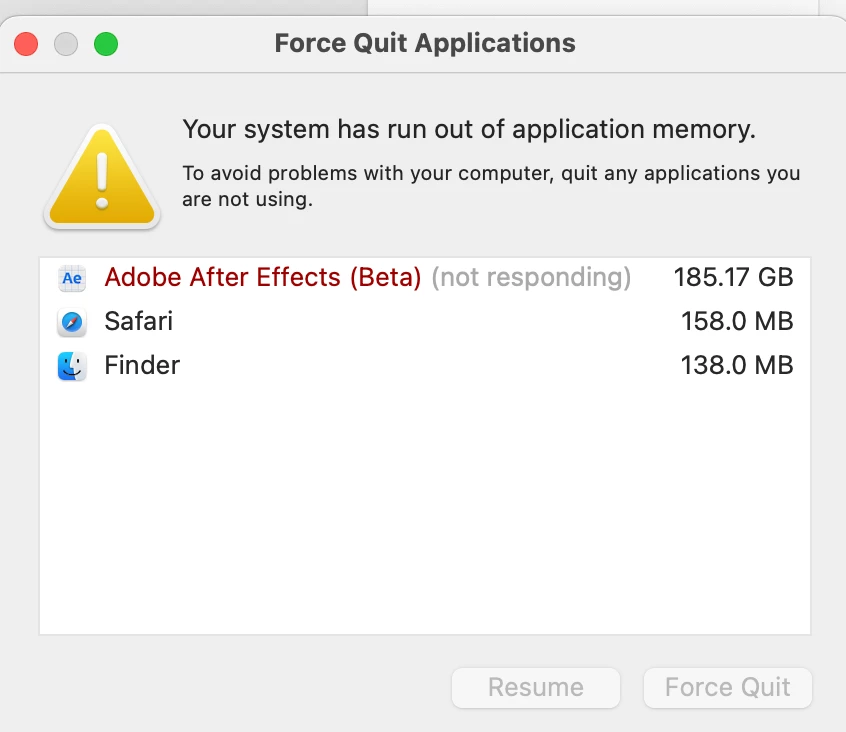

AE 24.4.1 Out of Memory
Your System Has Run Out of Application Memory-
Still happening.
AE 24.4.1
M2
96GB
Sonoma 14.5

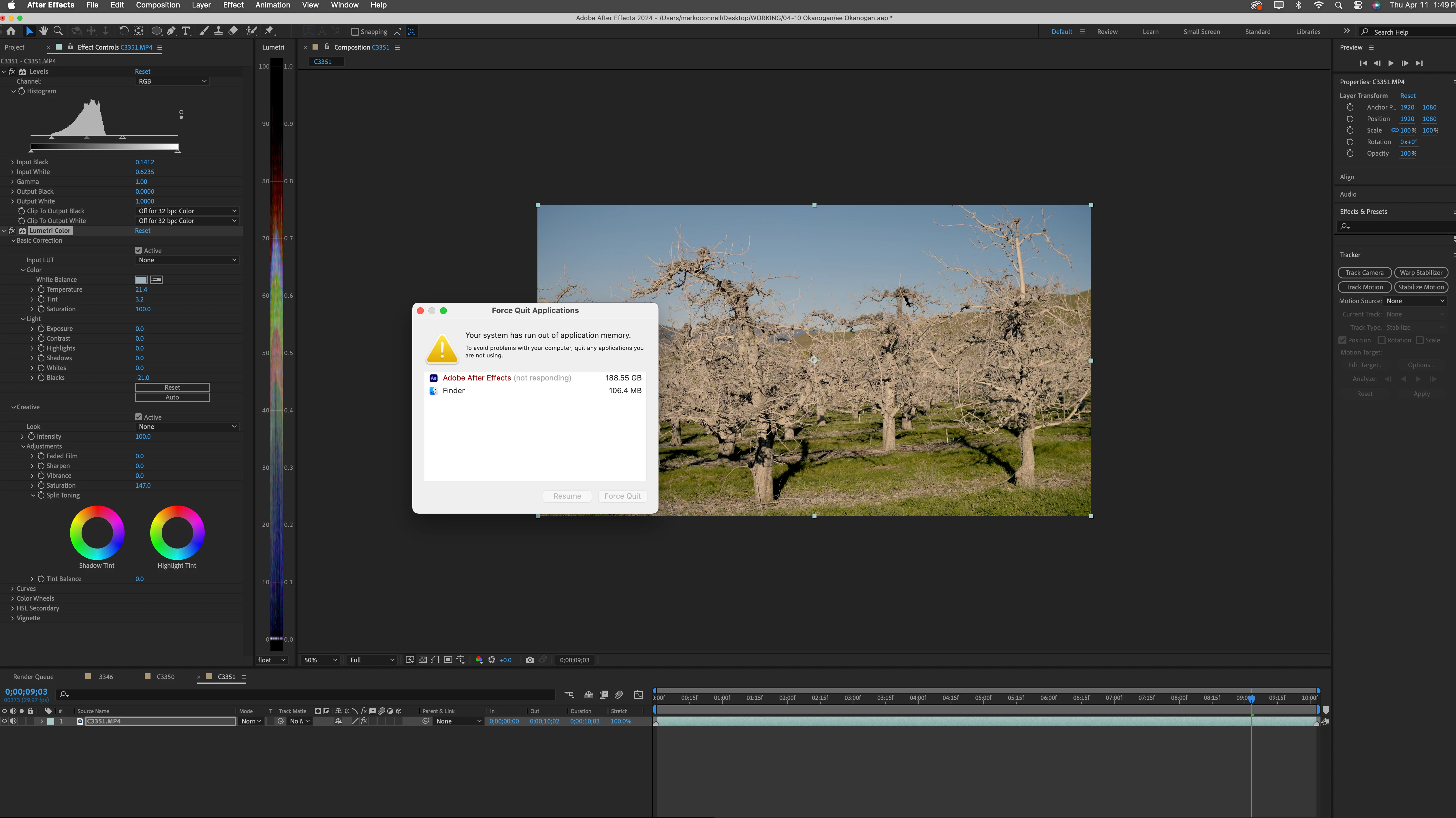

I'm still having problems with AE stealing all the memory and having to force quit. I thought I'd mention that Lumetri Color usually seems to be involved.
M2, 96GB, Sonoma 14.4.1, AE 24.3.0
Just crashed again. Pushing the saturation level to exrtremes in Lumetri can break it.  Try it.

Apr 25, 2024 9:06 PM UTC
This has happened repeatedly on multiple projects. They are usually very simple projects that are mainly for color correction. One or two layers of h264 or h265 from a Mavick 3 or DSLR. Compostion framerate 29.97, usually UHD. Not a lot of effects, usually  just curves or levels and Lumetri. The only other thing I'd add is that the problem doesn't seem to be cumulative, like the memory is being incrrementally taken away. More like there's a trigger that may be connected to pushing the saturation.
