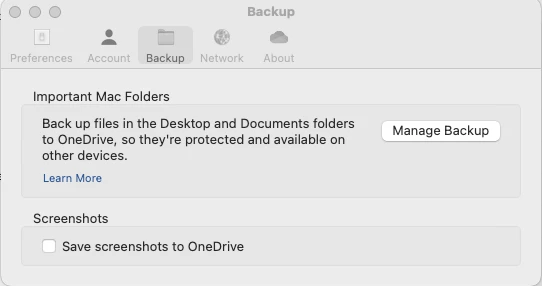

The only way I got it to work was to stop it syncing the Desktop and Documents folders on the mac. I had to work with my IT department and get permission to do so, but once that was done the problem was fixed. I'm not sure if it has been fixed on Adobe's end, but that is a Onedrive solution on how to address. See screenshot below on where this is in the UI.
