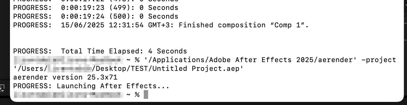

After Effects 25.3 update for mac still does not resolve this issue. Now, no error is logged, aerender stops the process with no aparent reason or log.
in the picture below you can see a completed compsition and below it the same comp with the Ciname 4D engine is selected. @
The process starts and quits
I'll be glad to be contacted to help and solve this issue. This affects all aernder users who use C4D render engine on mac (studios mainly)
