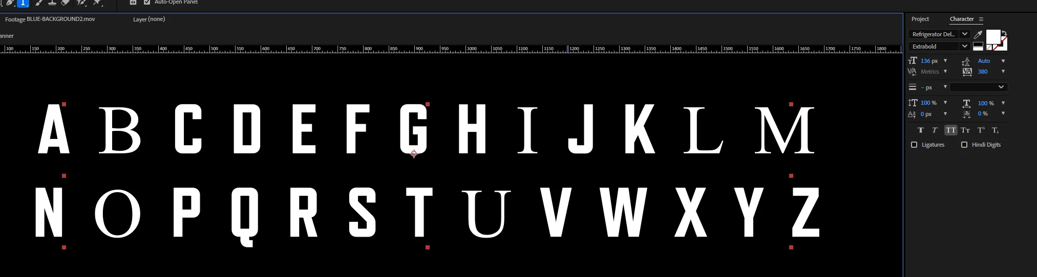

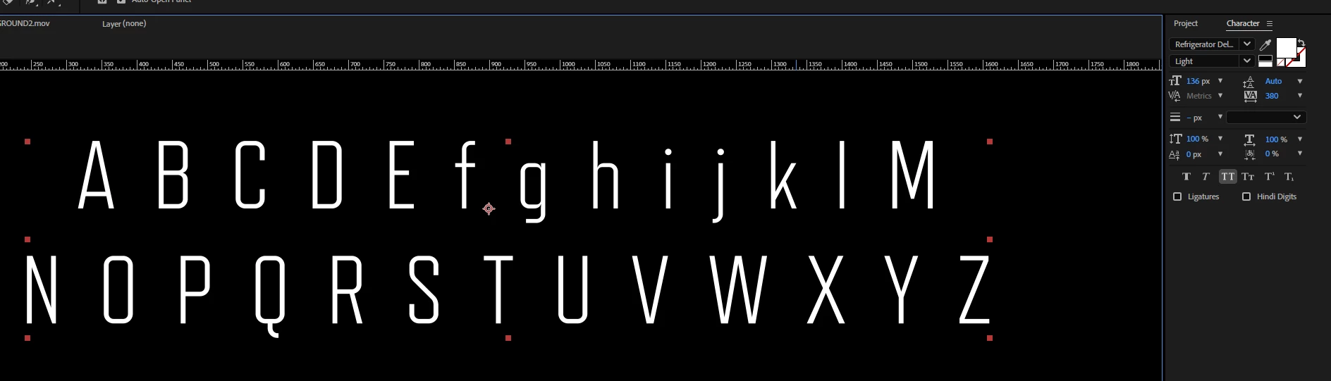

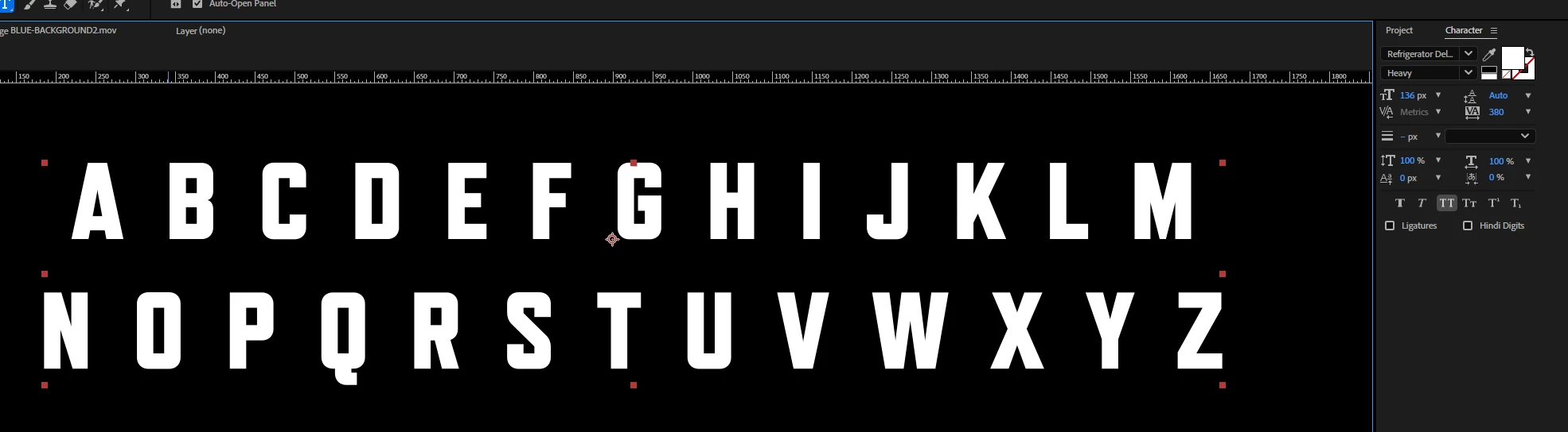

After updating to 22.2.1 build 3 I've got strange problem with "All Caps" feature in Character control.
Some letters are "caps" and some are not, some letters can be made bold after that and some not. No issues like that were present in previous version.
See attached file. If font is anything else that "Regular" "All caps" is tottaly crazy.

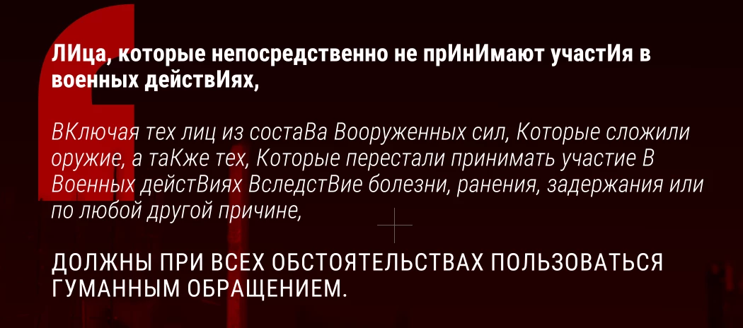

Hi everyone. Have fun to see this bug second year.
Any methods to fix it are not working, but…
  1. I see it in projects from AE 24-26.
  2. OTF type fonts.
I solve it (i hope, to solve) by 2 steps.
  1. Clean all text attributes by script:
    var l2 = obj.property("Source Text").value;
    var l3 = obj.property("Source Text").value;
    l2.resetCharStyle();
    for (var key in l3)
        try
            {l2[key] = l3[key];}
        catch (err) {}
    obj.property("Source Text").setValue(l2);
obj is a your text layer link, like obj = app.project.item(1).layer(1);
this script reinits all text settings and repair it again, some dirty properties will be cleaned.

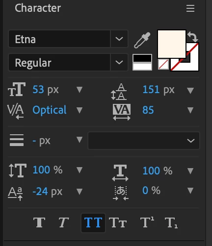

  1. Sure the AllCaps and fauxBold tuned OFF
  2. enter a simple expression text.sourceText.toUpperCase()
will works.

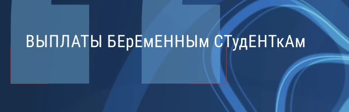

April 2, 2024
Had the same issue today. Details of how I think the issue happens below.
Text had been animated using Source Text keyframes. I had later changed the font using expressions.
Each keyframe has "ALL CAPS" applied in the character burger menu.
Most, but not all capital "D" and "L" were turned lowercase after exporting to media encoder.
I also tried adding all caps into the exporessions panel. This sometimes changed certain characters back to the original font, not the font specified in the expression panel.
Resolution: I've found that the video renders normally in aftereffects render queue, the issue seems to be with Media Encoder, or maybe whatever dynamic link thing-a-magig is doing.
Please dont come for me for my workflow! I'm just a graphic designer trying to get by!
