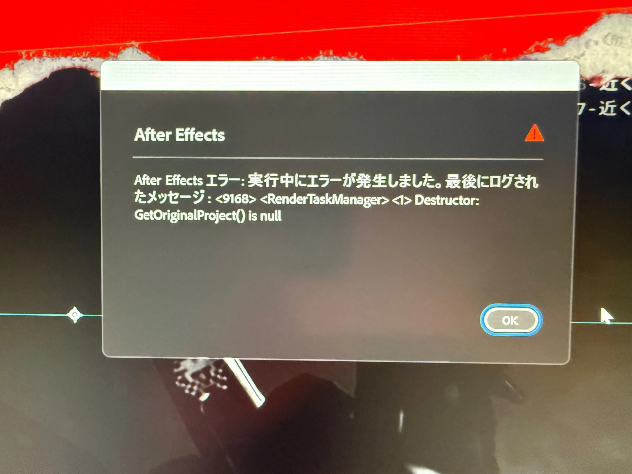

Internal Error
Sometimes After Effects displays the following message before closing:
<RenderTaskManager> <1> Destructor:
GetOriginalProject() is null

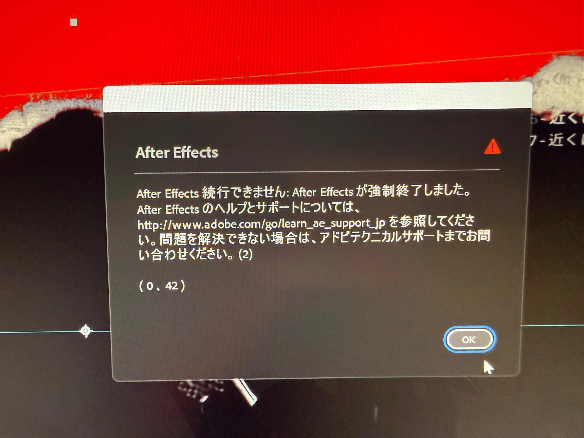

Immediately afterwards After Effects reports:
After Effects has crashed (0,42)
before closing.
