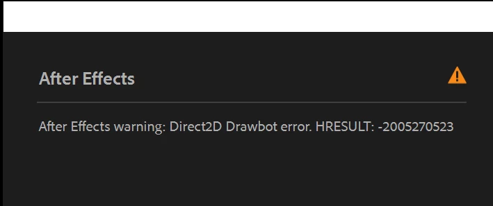

I can't say for sure, but after two or three more recent versions of AE Beta I started to get a random error, after working for a few minutes the whole computer crashes and then this Direct2D Drawbot Error box. HRESULT:-2005270523 appears, but I can't close it, it keeps reopening endlessly and then I have to force close the program.
I've been using AE Beta since they redid the interface, it's just become another program! It's very fluid and enjoyable. I'm not using to use the retail version because he not received the interface update., but I can say that the problem is in the beta, because when i use the reail version there is no issue i don't have any errors or freezes.
Here's a picture of the error I get when I close.
AE Beta V24.6.0 b23
Windows 11, i7 9750H, GTX 1660TI 6GB, 32gb de RAM, 512gb SSD.
Driver Nvidea Studio  555.99.

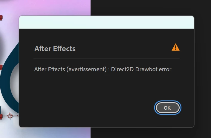

Got the same issues as you all, since like a year (it was making the computer go all black screens and taking at least 10 to 30seconds to get back to a blocked pop-up, AND, it was making Windows10 itself 'jump' (just like you'd force close Windows  Files Explorer), changed computer entirely (from win10/2070super with 8gb VRAM to win11/4070TiSuper with 16gb of VRAM, both 64Gb of RAM)
Most of the time it's when i'm scrolling through fonts that it happens, it makes a hundred pop-ups error windows (i just keep Echap button pushed to get out if i can) and then I get stuck if i go back to font panel and i've to alt-F4 AE, I did an update from 25.2.2 to 25.2 this morning because i had some bugs, but it doesn't change anything.
So what I end up doing is deleting the font that seems to make AE lose it, it's really not a solution and i don't even know if that does something.
Only lost the HRESULT into the pop-up;  here is the error message from this morning;
