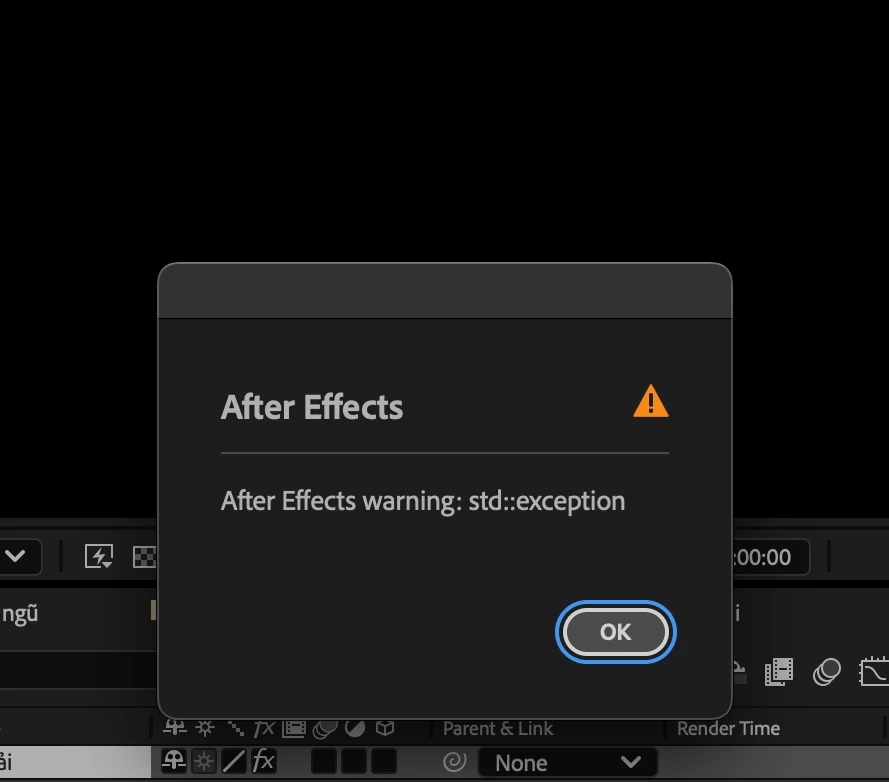

After Effects warning: std::exception
I'm using Mac, the app has operated well, but this error showed up while I was previewing my video.
How can I resolve this issue?

machii6Author
Jul 14, 2025 6:17 PM UTC
This issue is not related to a specific piece of footage or video file. The error occurs regardless of which media I use.
It only happens when I add a Repeater to a shape layer to create an infinite tunnel loop effect. If I hide that layer, the preview works fine.
Steps to reproduce the issue:
1. Create a shape layer (e.g. a rectangle or ellipse)
2. Add a Repeater to that shape layer
3. Adjust the Repeater’s transform properties to create a tunnel effect
4. Press spacebar to preview → the std::exception error appears
Please let me know if you’d like me to share the project file or exact Repeater settings I used.
