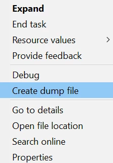

When you launch v25 on Windows 11 without compatibility mode, in the task manager, could you create a dmp of the application? Right click on AE in the processes list and choose "Create dump file"
It will create the file and give you the option to open your explorer to the file location. I don't think the forums allow you to upload dmp files, but if you could upload it somewhere and then DM me a link, it would help us to see where the application is getting stuck in the loading process.
